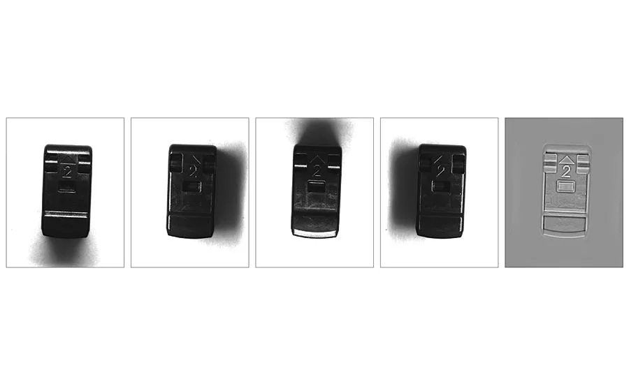

Figures 1-4. In these photos, the black plastic clip is illuminated from linear miniature (LM) LED lights positioned at 90-, 180-, 270-, and 360-degrees around the tire’s perimeter and controlled by an LED Light Manager (LLM). As the camera triggers each exposure, the LLM triggers a light from a different direction. The camera feeds each image into a PC running an image library photometric stereo registration algorithm, which takes the best pixels from each image and combines them into one composition (figure 5) that reveals more than any constituent images. Photos courtesy of Matrox Imaging

For example, reading raised letters on parts has always been problematic for machine vision systems, regardless of whether the part is a truck tire or an automotive clip. In this example, a plastic connector has several functional features on its surface as well as the number “2” and a directional symbol. As you can see from the constituent images, there is no difference between material that comprises the clip and the raised letter, hence there is no contrast. On larger objects, such as tires, manufacturers have used laser triangulation systems to create a 3D surface map. Laser scanning systems for 3D measurements have become much more integrated and effective, but are still costly solutions, often requiring the object to be moving during inspection, adding to the cost and complexity of the automated solution.

In figures 1-4, the black plastic clip is illuminated from linear miniature (LM) LED lights positioned at 90-, 180-, 270-, and 360-degrees around the tires perimeter and controlled by an LED Light Manager (LLM). As the camera triggers each exposure, the LLM triggers a light from a different direction. The camera feeds each image into a PC running an image library photometric stereo registration algorithm, which combines all corresponding pixels to establish local surface properties—like curvature—and produce one or more types of composite images from these such as a contrast image of the local 3D geometries or an albedo image (figure 5). These composite images reveal more than any of the constituent images by themselves. The resulting composition clearly shows the edges that form the black-on-black lettering on the clips surface, as well as the edges of the various injection molded parts that make up the whole.
