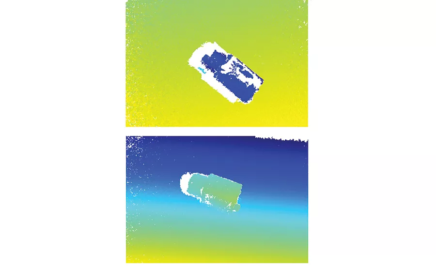

Specular reflection provides a challenge when using stereo vision. As any machine vision professional could tell you, reflective surfaces are difficult to image if you have little control over the environment.
In stereo vision with projected light, this can be an issue since the primary light source is at the same angle as the two cameras. A simple solution is to place the camera at an angle that is not parallel to the target surface. A second solution is to use multiple stereo vision cameras. Where one camera will catch the glare of the light source, another at a different angle will not. This second camera will also provide more complete 3D data than a single camera.
If the projector or primary light source is separate, set up a dark field light source, which has an angle of incidence less than 45 degrees. Adding a polarizing filter to the cameras will help with reflective surfaces, though they also decrease the amount of light passing to the sensors.

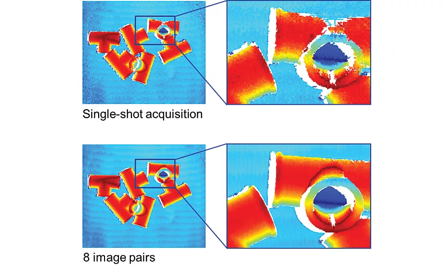

Stereo vision systems are well suited for grabbing moving objects, as the technology does not rely on known movement of an object. If the object is moving quickly through the system’s field of view, stick with a single image capture and lower the exposure time to compensate for its movement.
If your object and camera can be stationary, consider a system that can shift its projected pattern and aggregate multiple images of the same object. This will result in more depth accuracy, but increased computational time.

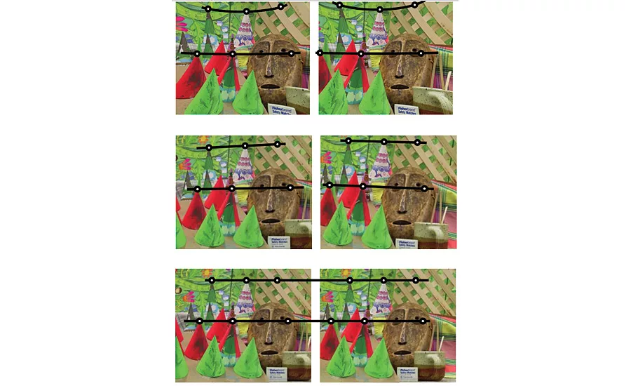

In a stereo vision system using semi-global matching, the cameras are a known baseline distance away from each other at a vergence angle facing each other to overlap their fields of view. The distortion is removed from the resulting images, and the images are rectified to provide two images in the same co-ordinate system.
The algorithm searches for matching features between these images, and notes the distance (in pixels) a matching feature can be found. This distance is referred to as a disparity. The system can use its calibration data to convert these disparities into the distance away that feature is from the camera.

Mounting the stereo vision system on the robotic gripper arm will provide you with multiple angles, and reduce the potential for specular reflection. Since the parts are not moving, the system can grab multiple images with a shifted pattern in each position that the robotic arm is in as it surveys the scene. This is required for the Z-accuracy, and will give better results in the presence of specular reflection.
The timing for this application is not too demanding at five seconds, but it will limit the amount of image pairs that can be captured. Adjust the disparity settings to limit the calculations to the 200mm Z-depth of the bin, but be sure to account for the depth at different angles. The disparity map calculated can then be transferred to a machine vision library for pattern matching. Experimentation is the best way to confirm the speed of the system.
