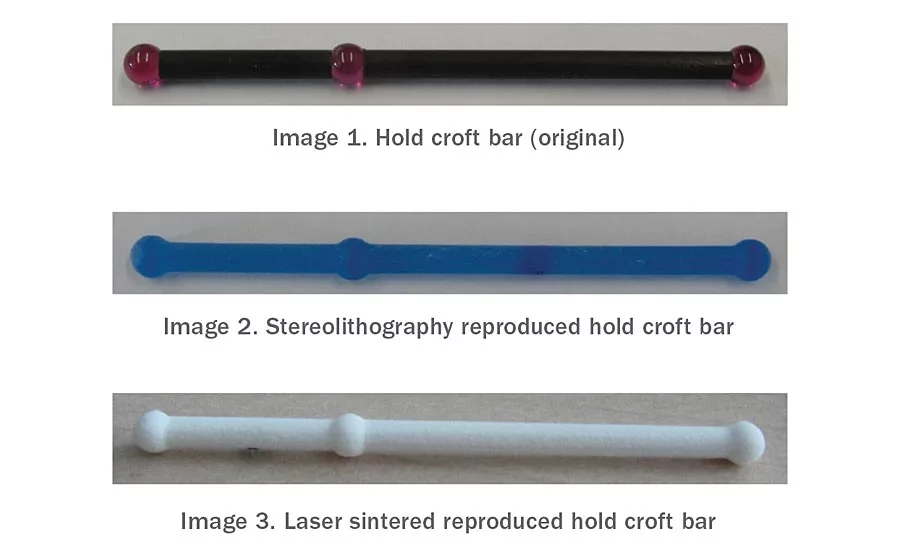

Back in 2010, a group of engineers and technologists from industry leading organizations including Fraunhofer EZRT, Bayerisches Laserzentrum, and Hochschule für Angewandte Wissenschaften - Fachhochschule Hof, gathered to perform an experiment to develop a proof of concept for 3D printing. The goal of this experiment was to determine the accuracy of each sub-step of the process. For the experiment, the specimen to be tested was a calibrated hold croft bar fabricated of a carbon fiber bar and ruby balls. (See Image 1. Calibrated hold croft bars are popular within the field of calibration of metrology machines and determination of measuring accuracy.)

Next, the group needed to generate the surface data of the croft bar in a stereolithography format (STL) using the marching cubes algorithm. Once the surface data was generated, the technologists employed two different additive manufacturing methods to test the reproduction of the croft bar: stereolithography (SLA), which is a technology used to create parts layer by layer, and selective laser sintering (SLS), which is a technique that uses a laser to sinteband bind powdered material in order to produce a solid structure. Each of these methods offer different positive and negative attributes to maximize the accuracy of the reproduction, and you should further investigate which method provides the best solution for your application based upon materials and size.
The surface data STL files were now used as input parameter for the manufacturing methods. The technologists went on to print 10 of the hold croft bars utilizing each method, SLA and SLS. (See Image 2 and 3.)
After manufacturing parts they determined uncertainty of measurement of both printing methods using the target vs. actual comparison of surface datasets generated with a coordinate measuring machine (used as a reference method). A coordinate measuring machine (CMM) is a device that measures the physical dimensions and attributes of an object. The measurements are determined by a probe attached to a three axis system within the machine which takes precise point data in 3D space. (See Image 4.)
Analyzing the target vs. actual coordinate measurements, it was discovered that SLS provided a higher accuracy reproduction as compared to the SLA. This can sometimes be affected by the unique attributes of each manufacturer’s printing machine.
