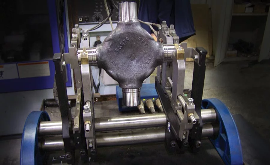

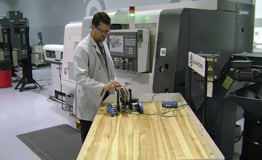

This modular bench gage is used to measure finish-machined heavy-duty truck cross trunnion parts produced on two Okuma L370 turning centers. Measurement data from the gage are processed and stored via the SPC statistical software on the machine controls. Source: Marposs Corp.

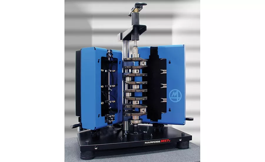

A semi-dedicated shaft measurement system such as the M57 bench gage for crankshafts is an example of the state-of-the-art at the higher end of the volume spectrum. Available in horizontal and vertical configurations, it uses contact technologies and interchangeable pin followers to handle families of parts. Source: Marposs Corp.

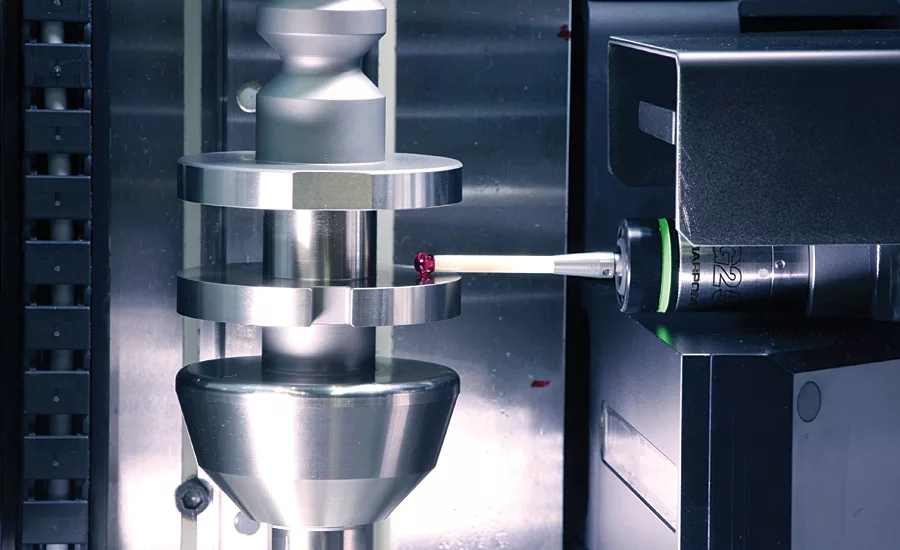

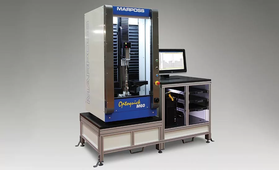

Medium volume production applications requiring an audit measuring system, or lower volume applications requiring 100% inspection are especially suited for a flexible, hybrid high precision gaging solution that integrates optical and contact technologies. Source: Marposs Corp.

Relatively low-volume parts are good candidates for extremely flexible “kit” type gages. In these, probes, transducers, gages, V-blocks, centers and other components are mounted on a precision machined baseplate in virtually any configuration necessary to measure the part. They are easy to set up and easy to re-configure. On the other hand, they are usually manually loaded, have relatively long cycle times and best applied to relatively small parts.
Contemporary semi-dedicated systems for crankshafts are good examples of the state-of-the-art at the higher end of the volume spectrum. These typically utilize contact technologies and interchangeable pin followers to handle families of parts. These systems are able to measure size and geometry of cranks with different throws, pin diameters, bearing diameters and bearing axial locations. Such systems offer flexibility within a relatively narrow range with minimal changeover downtime. They are not, however, easily re-tooled or re-configured for parts outside that range.
The volume middle ground is increasingly occupied by a new class of flexible, hybrid gages that combine optical and contact technologies to measure size and geometry. Since both technologies are available, these systems can be applied to parts with turned and ground surface features, as well as to geometries such as re-entrant cam lobe profiles.
A typical example of this new class of gages utilizes Shadowcast technology for the optical measurements, and a precision gaging probe for the contact measurements. The light sources and receivers and the mechanical probe are movable along the length of the part to measure multiple features. Motions are under program control and positions are tracked with precision glass scales.
Shadowcast technology uses a calibrated light source on one side of the part and an optical sensor on the other. The sensor counts the pixels in the shadow cast by the part to determine the diameter with an accuracy of ± 0.1 micron.
The mechanical scanning probe can measure features like key slot widths or other non-visible features, like run out, with an accuracy of ± 0.5 micron. The accuracy difference is explained by the fact that the contact probe uses position data from both a glass scale and a rotary encoder to determine run out and any encoding errors are cumulative.
This particular system can be manually or robotically loaded, and has a cycle time of roughly 60 seconds measuring a typical crank or camshaft. Today, this kind of system is most often used to audit families of parts or batch runs of multiple part types,
