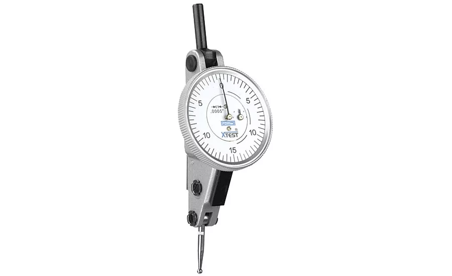

The accuracy of these gages can be improved with the addition of a dial test indicator. This gains the benefit of resolution down to .0001 inch. The negative side is that the gage is reduced to being a repeating device. This increased accuracy is only effective within the range of the test indicator. This range is measured in hundredths of an inch. The travel range of the height gage is sacrificed, and a master gage block must be used to reference the desired height value.

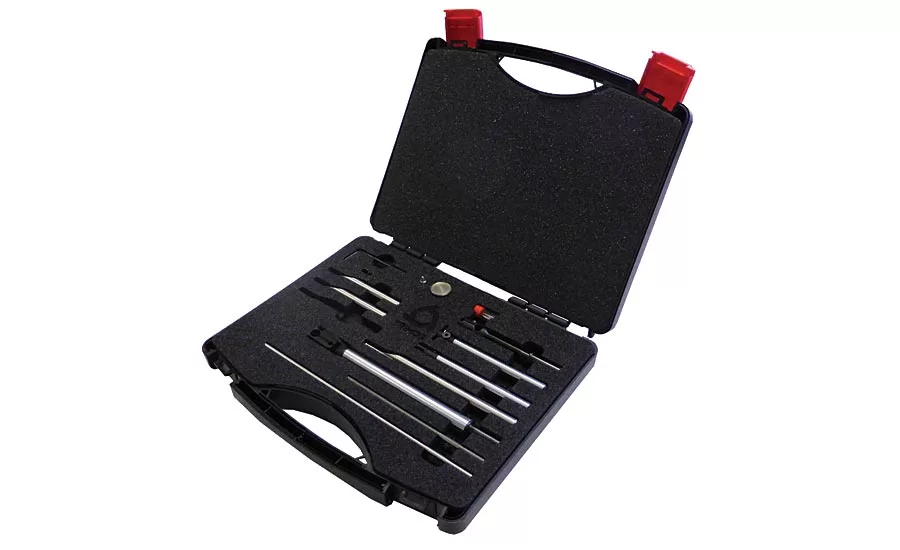

Since the flex in the measuring probe can be ignored, we are now free to have a plethora of probe attachments with different diameters, lengths, and angles. Many odd or deeply buried features are now measurable.

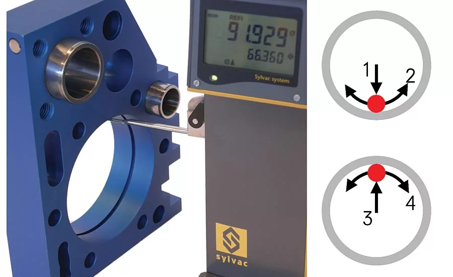

Building on this, the probe can sprung in both directions. If the height gage can tell which way the probe is deflecting when a reading is triggered, then the diameter of the probe can be recorded and subtracted from upward measurements. Now the gage is capable of measuring slot widths or thicknesses. It switches from down to up measurements seamlessly with no input but the measurement itself.
The next step in this progression is the ability to measure diameters. For this, the electronics must observe a stream of readings and lock onto the lowest point, then watch for the highest point on the next reading. The difference between these two points is the diameter. The average of these two points is the centerline. Only a little bit of processing power and memory was required. The physical components were already in place.

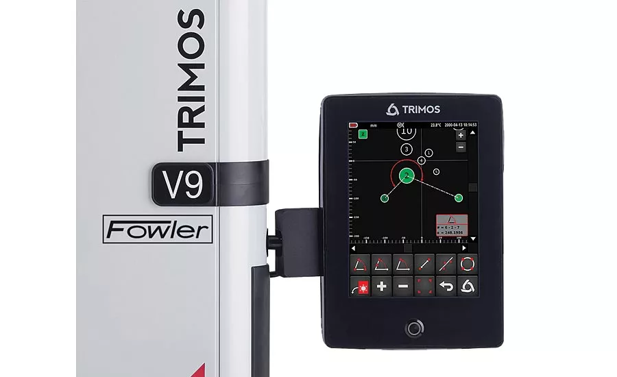

Modern height gages are able to take diameter measurements from 1D to 2D with a little bit of geometry. By measuring a series of holes, then rotating the part a known angle, and re-measuring these features in the same order, an X-Y map of their positions can be built. This can be used to check angles, off-axis distances, and even bolt circle diameters relative to the center point of the measured features.
