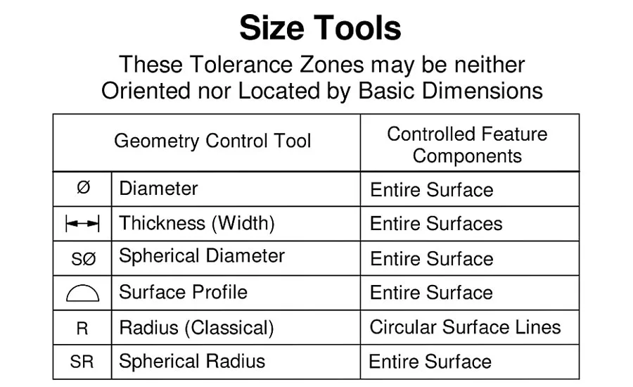

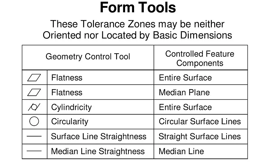

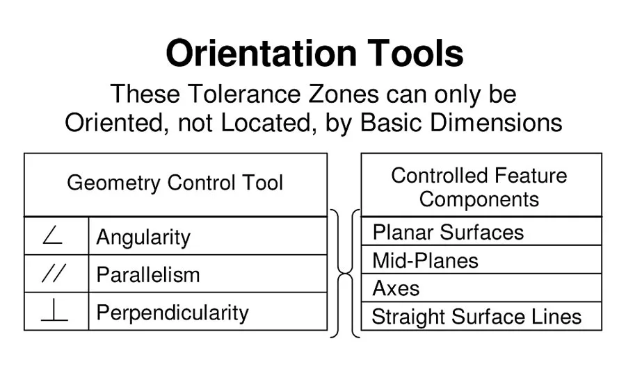

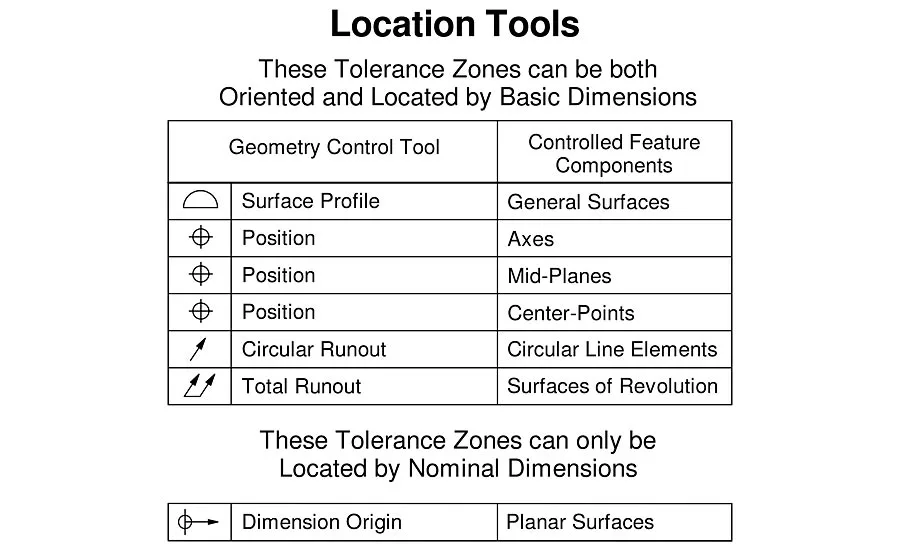

Geometry Control Tools
There are only four things that can go wrong with the geometry of machine parts: 1) size, 2) form (including finish), 3) orientation and 4) location. There are also four sets of “tools” with which to impose constraints on what can go wrong. The following charts list all the truly functional tools in the Y14.5 2009 set, and include their names, their symbols, and the feature components they control.

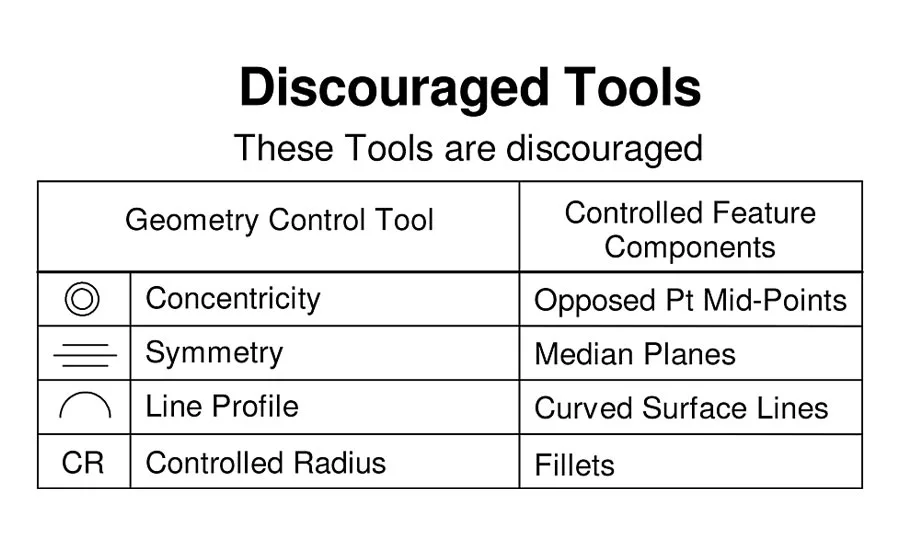

In addition to the tools referenced above, there are some of highly questionable value, whose use is “discouraged” based on explanations provided in the online resource:
