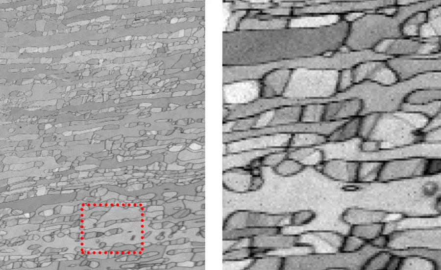

By way of example, Fig. 1 shows an example of OIM and the information content available to the user. The case study involves the analysis of a duplex steel, containing approximately equal amounts of ferrite (BCC) and austenite (FCC) grains. Of particular interest is the grain sizing, distribution and inter-orientation grain relationships between the ferritic and austenitic phases as this gives insight into the ductility and stress resistance within the material.
The samples were analyzed with an EDS detector and an EBSD camera. EDS phase mapping was performed using a principal component analysis technique, as developed by Paul Kotula at Sandia National laboratory [1, 2] and employed in a phase mapping software package. Maps were acquired at 20 kV accelerating voltage with 1024 x 768 pixels and a 0.5 micrometer step size and exposure time of 1.5 ms, meaning the analysis time was approximately one hour.

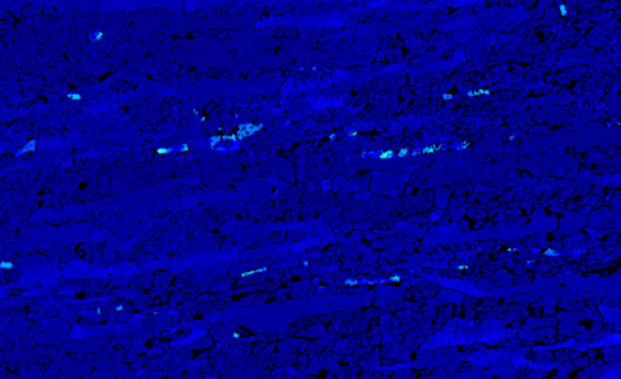

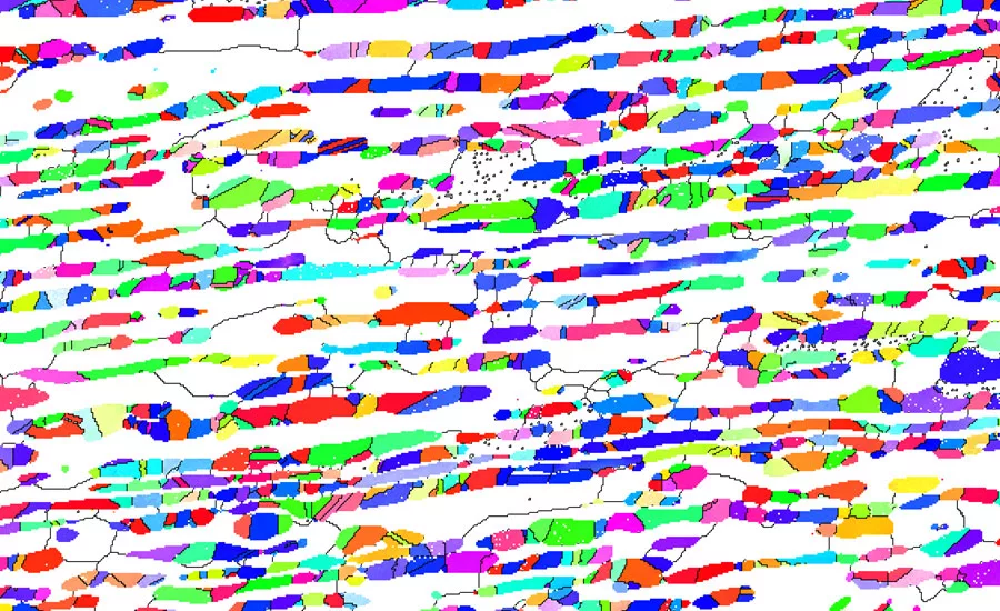

Interpretation of the data begins with band contrast imaging, Fig. 2a, which gives a measure of the quality of the diffraction pattern at each pixel and is therefore related to the underlying crystallinity. Grain boundaries and defects typically yield low quality diffraction patterns as represented by darker pixels, while the overall contrast of individual grains is related to the grain orientation. The enlarged image, Fig. 2b, shows the distribution of grains across the sample: there are distinct types of grains, one with large continuous features and another made up of smaller twin grains, signified by the straight-lined grain boundaries.

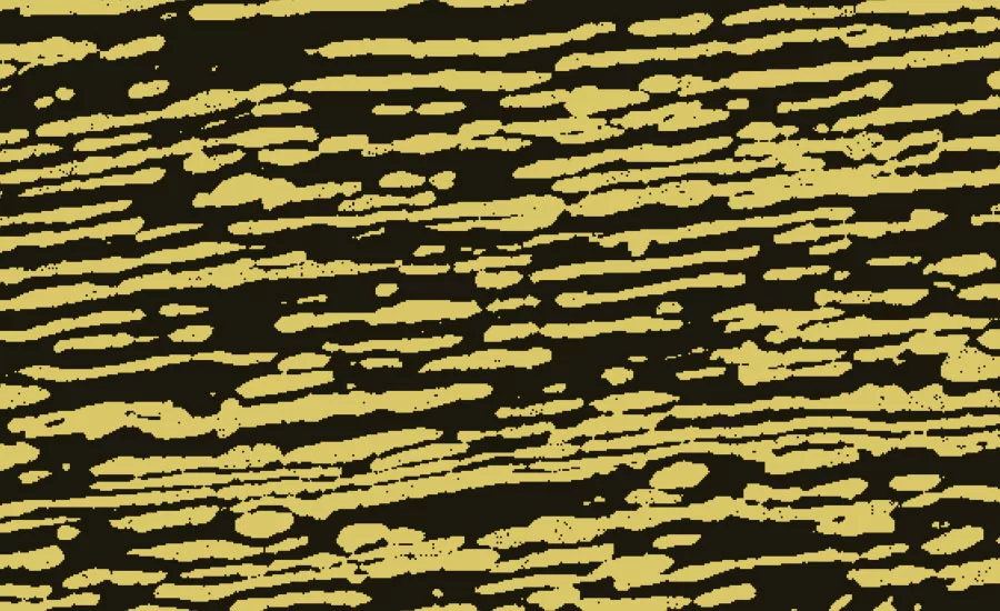

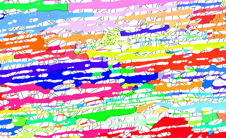

Probing the data further, a phase plot, Fig. 2, reveals that the larger grains are ferrite and the smaller grains are austenite. The orientation maps for ferrite, Fig. 2a, reveal large, continuous grains without a preferred orientation. The distribution of austenite, Fig. 2b, shows a high number of twin boundaries within these grains. Overall, there was no relationship observed between the orientations of the austenite and ferrite phases. Figure 2c is a plot of the average orientation of each point in the grain relative to the average for the grain. Figure 2d shows the strain analysis across the material.

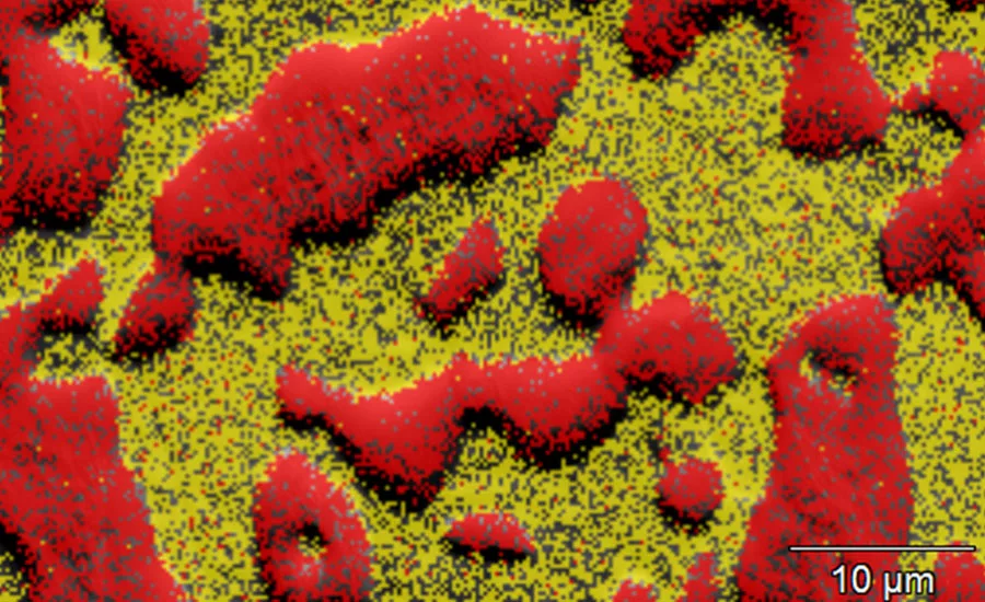

High magnification EDS phase maps were generated as described earlier and displayed in Fig. 3. The red and yellow EDS phase maps correlate neatly with the austenite and ferrite phases identified with EBSD. Cr and Mo are ferritic stabilising alloying elements. A quantitative analysis of the software phase maps indicates a 4% increase in Cr and 2% increase in Mo—at the expense of Ni—in the ferrite phase relative to the austenite phase. While subtle, this difference is sufficient to define the two unique crystal structures.

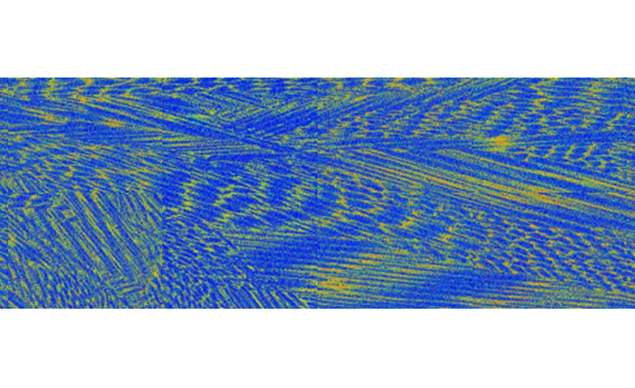

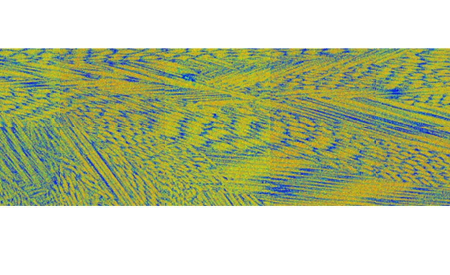

This concept of large area quantitative phase mapping is demonstrated on a sample of stainless steel 304 that underwent rapid heating and cooling during a welding operation. The weld was performed in the transverse direction (left to right) shown here. EBSD and EDS had previously been used to determine that the BCC ferrite phase had between 7.5% - 8% Ni. As the metal cooled, Ni was rejected from the ferrite, and FCC austenite with approximately 10% - 11% Ni formed in the boundaries between the ferrite grains. An EDS-only acquisition was then performed over a large area of the sample and phase maps of the elemental distribution were generated using the software’s PCA algorithms. The region of steel studied was 5.5 mm long by 0.65 mm tall. This compares to the previous study that covered an area of 0.5 mm wide by 0.5 mm tall.

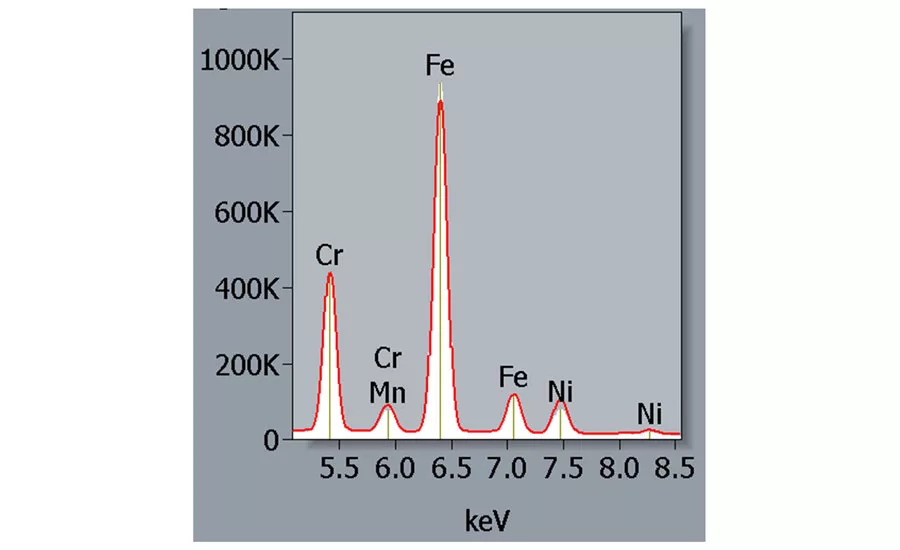

The resulting EDS software phase maps are shown in Fig. 4a and Fig. 4b. The two dominant components (i.e. chemical phases) are immediately apparent. The EDS spectra extracted from each phase and overlaid on each other are shown in Fig. 4c. The two spectra are nearly identical with only small differences in the EDS peak intensity of Ni and Fe. The quantitative results, Fig. 3d, demonstrate that phase one, with 7.68% Ni, is BCC while phase two, with 10.4% Ni is FCC.
Using this correlative approach, the FCC and BCC phases, including grain size and distribution, were effectively determined without the need to run concurrent EBSD. The details regarding the orientation of the BCC and FCC grains are not obtained. However, the ability to analyze a region roughly 15 times larger while maintaining sub-micron resolution provides both the fine detail of the material structure and the broader overview needed to both see the “bigger picture” of information in the sample and to sample a large enough number of grains for proper statistical analysis of the grain structure. For example, the grains identified here are long, thin and aligned with the direction of the weld.
