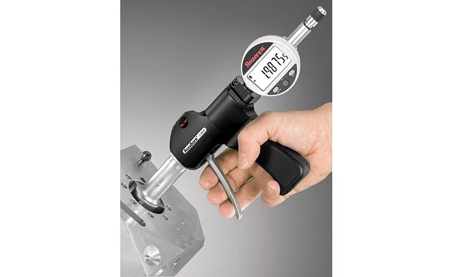

This electronic bore gage offers Bluetooth capability.

For the most productive and efficient bore gage measuring solutions, it is beneficial to take some time to examine technology options. Choosing the right gage for your application will ultimately save tens of thousands of dollars and lead to increased accuracy. To begin the selection process, it is useful to review how you collect and record measurement data.
Machinists, inspectors and engineers use bore gages to check inside diameters of holes, cylinders and pipes. Dimensional part data are usually never collected. When collected, the data are often manually collected and entered into a Microsoft Excel .csv or .xls file so that basic tolerances can be controlled within a large lot quantity of parts, or documentation can be produced in the event of a commercial discrepancy.
With manual inspection data collection, the repetitive hand movements required to pick up tools, measure parts, put tools down and then record results is time consuming. Furthermore, hand writing or keying in data is error prone, resulting in scrap, excess inventory and even rejected parts.

This electronic bore gage provides IP67 level of protection as well as Bluetooth capability.
Considered a level above manual data collection, collecting the data via a wired cable connected to an electronic gage can be a useful option. However, there are even more productive solutions where wireless technologies in tools such as a bore gage transmit the measurement data wirelessly to another device. Looking ahead to Industry 4.0 initiatives, it will be increasingly important to instantly share consistent, accurate data throughout an organization.

When it comes to measuring holes, especially when there are a large quantity of holes, Bluetooth enabled bore gages can easily and wirelessly collect this data. The technology enables users to measure and collect error-free data to output for statistical process control (SPC) analysis and much more. Issues with data cables are eliminated including placement, installation, safety and high cost, and gages can easily be brought to the hole.

Electronic bore gages have a high-quality, trigger-activated, two and three-point contact gaging system with extended range.
