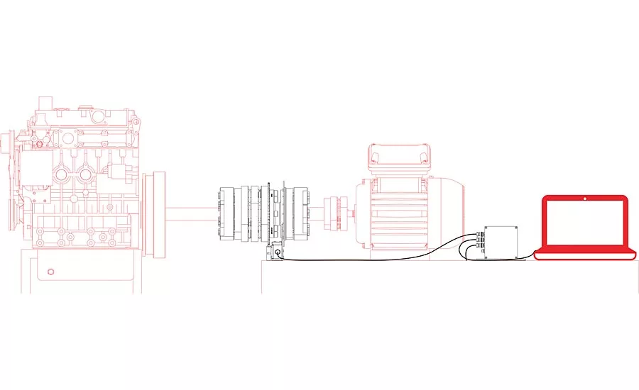

Engine Dynamometer Testing
In this application example, a rotary torque transducer is used to measure the speed and torque of an engine. This rotary transducer can sense the torque of the engine with high precision and provide an electrical output that is converted from an analog to a digital signal. A rotary transducer is necessary due to the spinning element involved in the engine. It’s paired with a very high-quality coupling and is mounted in a fixed position. Both are necessary to account for the high speeds used in the test. This application would allow the user to measure both torque and speed of the engine simultaneously, which will provide valuable data in confirming the design of the engine or determining if it needs to be adjusted for the vehicle it will drive.
