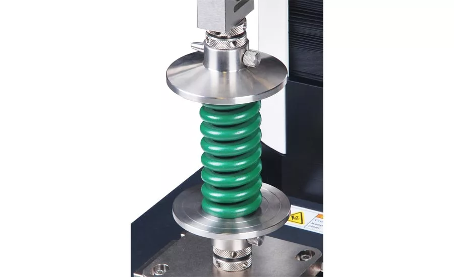

Compression Spring Testing: Springs are essential components in everything from pens to mattress to automobiles. To ensure optimal performance, a compression force is applied to determine corresponding force. Several parameters are often measured, including spring rate, spring force, force at a given deflection, and deflection at a given force. Understanding the mechanical performance of a spring is critical in specifying which spring to use in a product design.

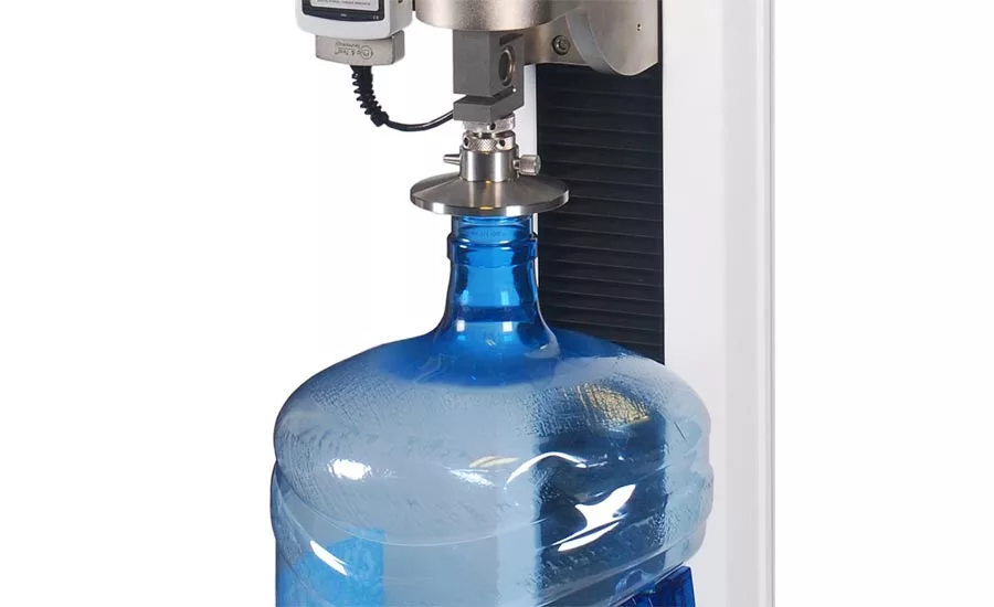

Top Load Testing: Top load testing is popular for packaging, beverage, and consumer products manufacturers. Bottles, containers, cans, and cartons are required to resist compression loads that could damage them. In top load testing, a compression force is applied until it deforms by a specified amount or collapses. An example of such testing is measuring the top load on a common water cooler bottle. Such measurements must meet minimum standards to prevent damage to the bottle or its contents during transportation or customer handling. The results of a top load test can identify failures in the molding process or in the formulation of the material.

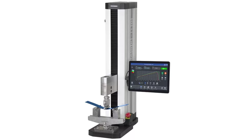

Bend Testing: Bend testing subjects plastics, wood, carbon fiber, and other materials to compression forces at three or four points. The resulting deflection and compression forces are measured, and used to quantify strength, elasticity, and other characteristics. This information helps materials producers meet specifications and assist other manufacturers in specifying materials in their designs.

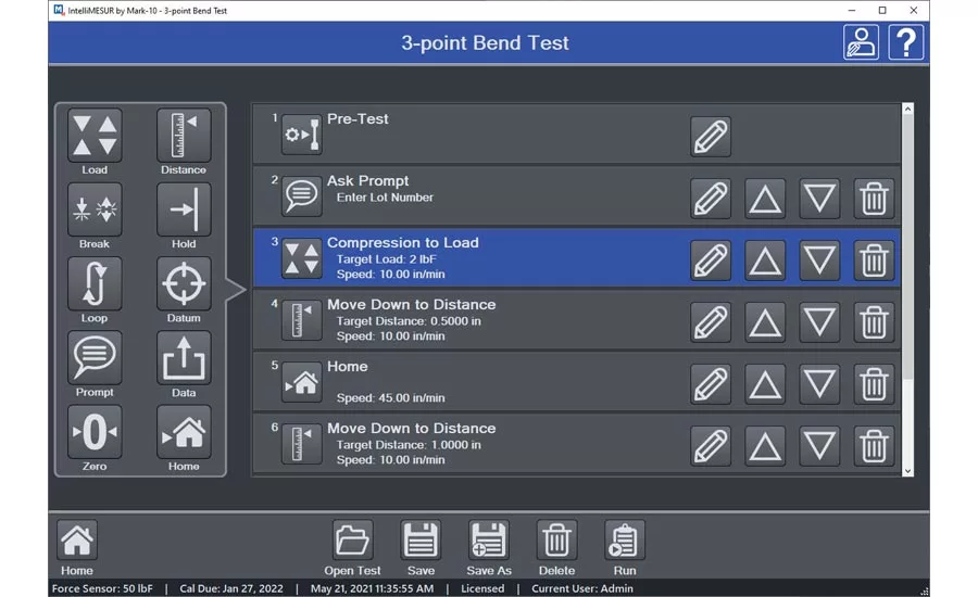

Using some of the above application examples, newer advanced software allows users to create custom test executions without any programming knowledge. Here are two examples:
Compression Spring Test to Multiple Heights: Springs may be compressed to a height to determine the resulting force and spring rate. For example, a test procedure might call for measuring the free (original) height, followed by one or more heights, as follows:
  1. Prompt the operator to enter a lot number
  2. Touch the top of the spring – pre-load of 0.2 lbF
  3. Measure the free height
  4. Compress to 4 in. height
  5. Record the force
  6. Compress to 3 in. height
  7. Record the force
  8. Return to home position
Fatigue Test of Plastic Material
Plastics are employed liberally in products we take for granted, with newer formulations taking the place of more traditional materials like wood and metal. To determine suitability of a material for a given application, a complex test procedure can be helpful, such as the following:
  1. Prompt the operator with instructions and an image of the testing setup
  2. Touch the top of the material – pre-load of 0.2 lbF
  3. Zero the travel display
  4. Compress by 0.5 in.
  5. Record the force
  6. Return to home position
  7. Compress by 1 in.
  8. Record the force
  9. Return to home position
  10. Repeat steps 2 through 9, 50 times

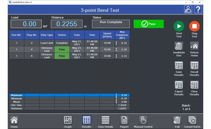

The results generated by these tests are displayed in tabular format directly within the machine control software. Selected results and operator prompt responses correspond to run numbers (for example, 10 runs in a batch). Statistics may be applied to the results of multiple runs to determine trends. Results can be output to a .csv file or used to generate a report for further analysis and record keeping. Previous runs can also be viewed on the graph simultaneously, to more easily compare the behavior of multiple samples.
