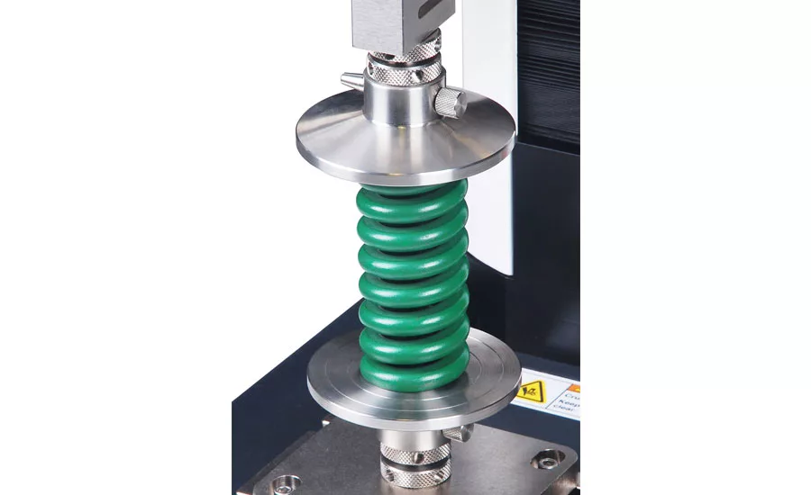

Spring rate can be determined by compressing a spring to one or more heights and measuring the corresponding forces. Source: Mark-10

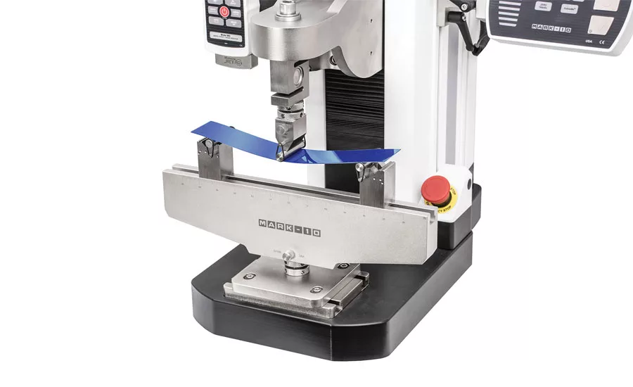

A three-point bend test characterizes a plastic material. Source: Mark-10

2. Plastics: Bend testing
The ongoing plastics revolution has improved the quality of life in areas as broad as medical devices, beverage packaging, construction materials, automotive components, and many others. With continuing innovation in materials engineering, proper testing is critical in qualifying a material before it can be used in a specific product design.
Among the many force tests common in the plastics industry, bend or flexural testing of a plastic strip can yield a wealth of information about the material’s performance. In this test, a sample is supported on two anvils of defined radii. The force is applied either centrally between the two lower anvils for a three-point configuration, or at defined positions on either side of the force axis, for a four-point configuration. The support beams are graduated in inches or millimeters to aid in proper anvil placement.

5. Springs – Compression spring testing
Used in an unlimited number of applications, from pens to cars, springs help ensure proper operation, longevity, and comfort. For compression spring manufacturers, it is essential to verify the characteristics of the spring. Machine designers must be able to rely on the specifications before they can integrate a spring into their design.
Of common interest is the spring rate, which is defined as the amount of force per unit of deflection. To measure the rate, a compression plate touches the top of the spring, while the position indicator is zeroed. A test procedure will typically call for the spring to be compressed to one or more heights, and the corresponding force readings are measured. These results are compared against the limits established by the designer. When the consequences can be life and death, such as in aerospace and medical applications, proper testing makes all the difference in the world.
