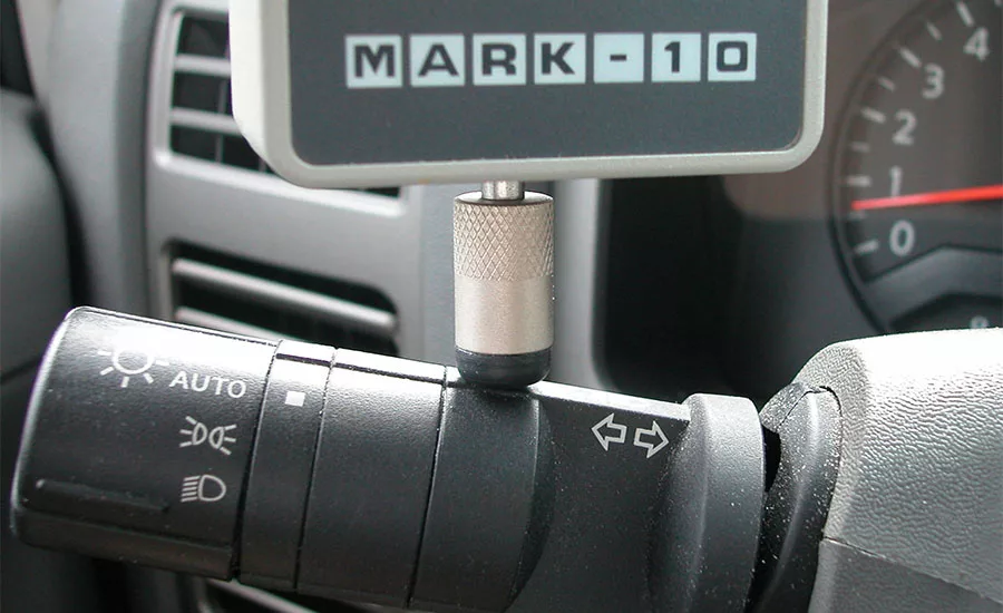

A turn signal stalk’s activation force is measured via nondestructive compression testing. Source: Mark-10

There are many NDT compression applications within both the automotive and electronics industries. Often, the two industries overlap as more electronics are integrated into vehicles. Force measurement can ensure vehicle performance and safety with NDT compression tests such as switch force activation and turn stalk activation. Each is measured using a force gage and a rubber tip attachment that can simulate a human finger in compression testing.
