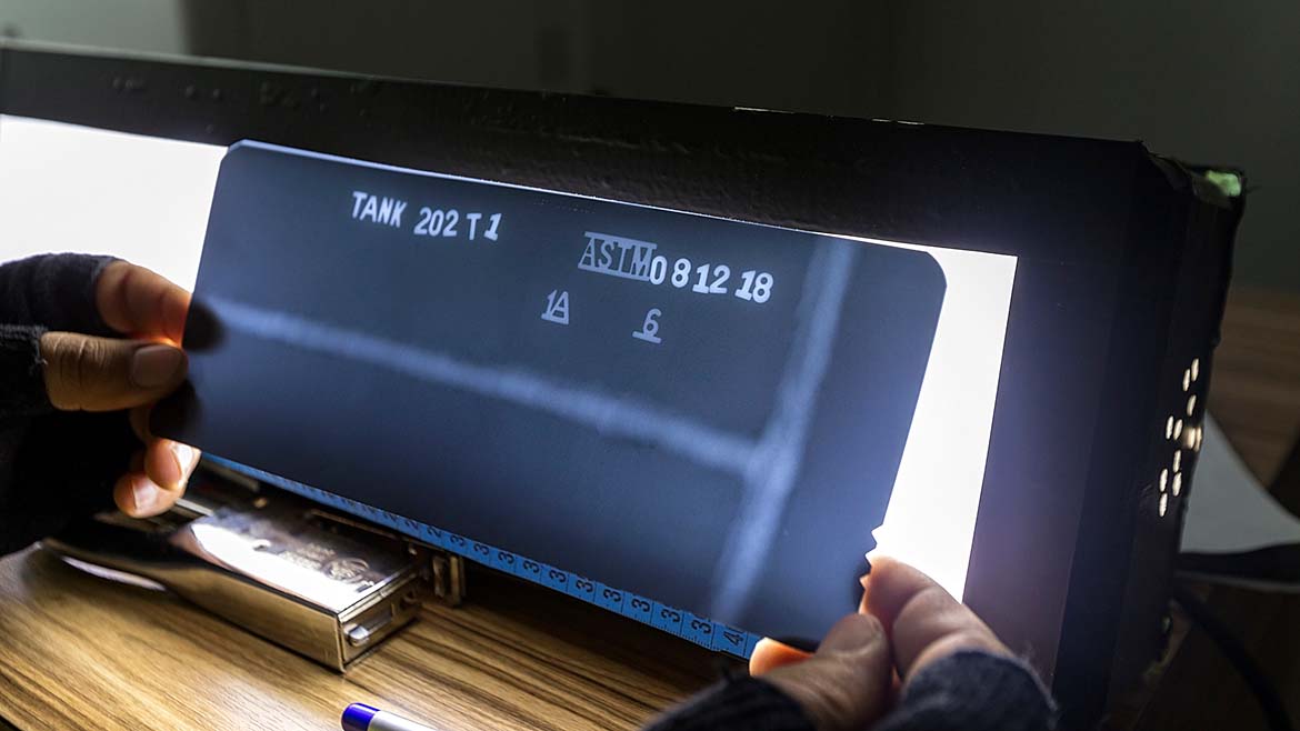

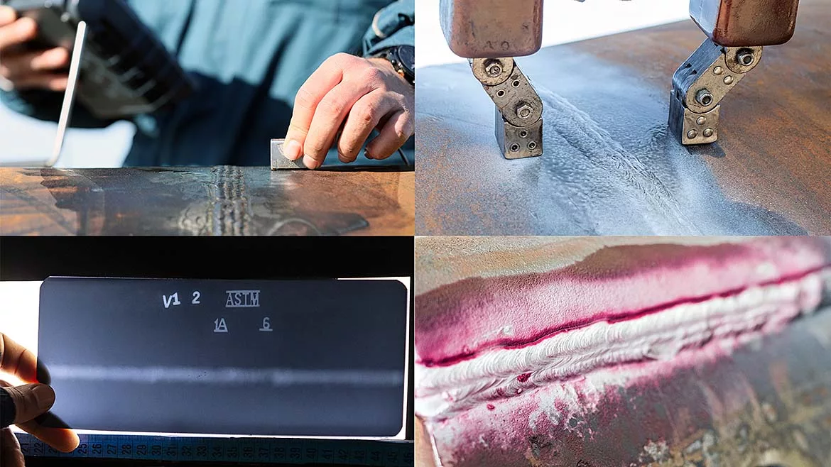

X-ray inspection has long been one of the most trusted methods for inspecting a part without cutting it open. Within the broader field of nondestructive testing (NDT), radiography remains a remarkably flexible tool—able to reveal hidden flaws, confirm weld quality, or verify internal structures that can’t be seen by eye. It’s used everywhere from aerospace and defense to energy, electronics, and manufacturing.
As with any NDT process, success depends on preparation. Before you reach out to a testing provider, it’s worth knowing the details they’ll ask for. Having that information ready makes conversations smoother, quotes more accurate, and results more reliable. Below are a few questions to think through before your first call.

4. What’s the Smallest Feature You Need to See?
Every X-ray setup involves tradeoffs between power and resolution. Higher energy allows deeper penetration but can reduce image sharpness. The slightest defect or feature you need to resolve determines which approach makes sense.
  • Conventional systems using film or imaging plates generally resolve down to about 0.010 in (254 µm).
  • Micro-focus systems, which use focal spots as small as 10 µm and high-resolution detectors, can see details as fine as 0.00008 in (2 µm).
If your work involves microelectronics, additive manufacturing, or intricate aerospace parts, that level of magnification might be necessary. Not every lab has it—so be sure to ask.
Industrial Radiography X-Ray kV Range Chart
This table outlines typical voltage ranges needed to image common engineering materials. Actual requirements vary with density, geometry, and setup, but the values below give a practical starting point for discussion.

Reference Guidelines
  • Film radiography typically uses 60–320 kV.
  • Digital panels and CR systems may operate from 40–450 kV, depending on calibration.
  • Steel sections thicker than 2 inches (50 mm) often require a linear accelerator in the 1–6 MeV range.
  • In most cases, using the lowest kV that still achieves full penetration produces the best image contrast and sensitivity.
