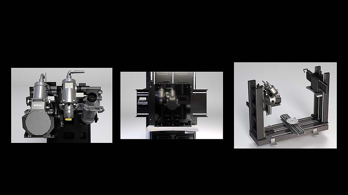

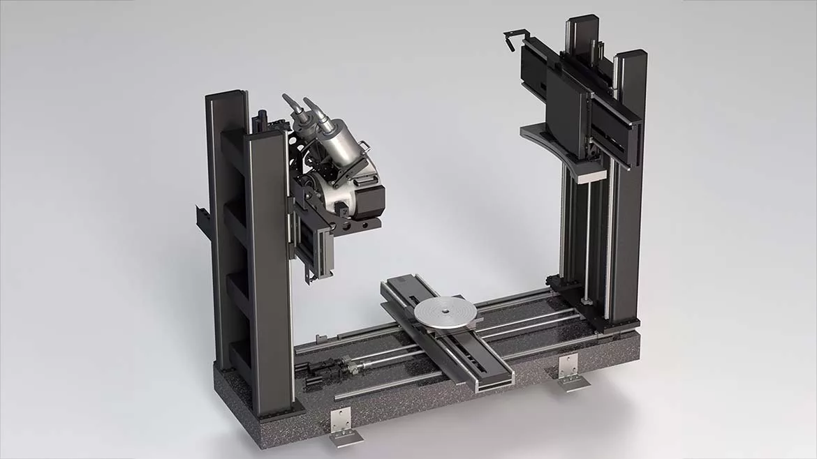

Manufacturers, inspection labs, and NDT training schools are adding simulation software and virtual training platforms to give students access to realistic practice without relying solely on physical equipment. Kyle Stoll, NDT program manager at Nikon Metrology, said simulation software has become an important tool for teaching both fundamentals and advanced techniques.
“We have explored the use of digital twin software for simulation of both 2D X-ray and 3-D computed tomography (CT),” he said. The technology allows instructors to design lessons around simulated defects that may not be available in physical parts, and students can practice techniques without waiting for access to expensive CT machines. Stoll added that simulations also help students apply their studies to the real world. “You can show a simulation output based on theory and then go to a physical system to see the theory play out in reality,” he explained.
In Nikon’s Inspection Services group, simulation has even been used to test defect detectability in parts that lacked a representative quality indicator. While not a substitute for real-world testing, Stoll said simulations “provide more confidence in defect detection than simply using nothing when an RQI does not exist.”

The pace of technology change in NDT creates challenges for training. Stoll described how CT scanning has evolved: “Traditional CT has involved having a part placed between the beam and detector and performing a simple circular CT. Over the years, scanning modes like helical motion have allowed technicians to scan something taller than the detector itself. Now there are many scanning modes—panel shift, offset, limited angle, pixel splitting, and tilted CT—that each have a unique application.” He said this evolution requires technicians to stay familiar with a growing toolkit.

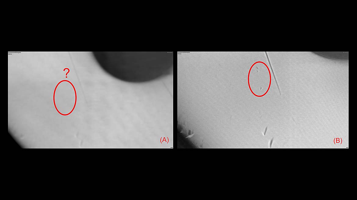

Gaps in training can lead directly to quality problems. Stoll shared an example where an operator used a screen capture function instead of a higher-quality image export. The decision cut resolution in half, which could have caused inspectors to miss flaws. “It came down to a lapse in training,” he said. “In this situation, the reduction in resolution could have resulted in less flaw detection and possibly passing something that would have normally failed inspection.”
