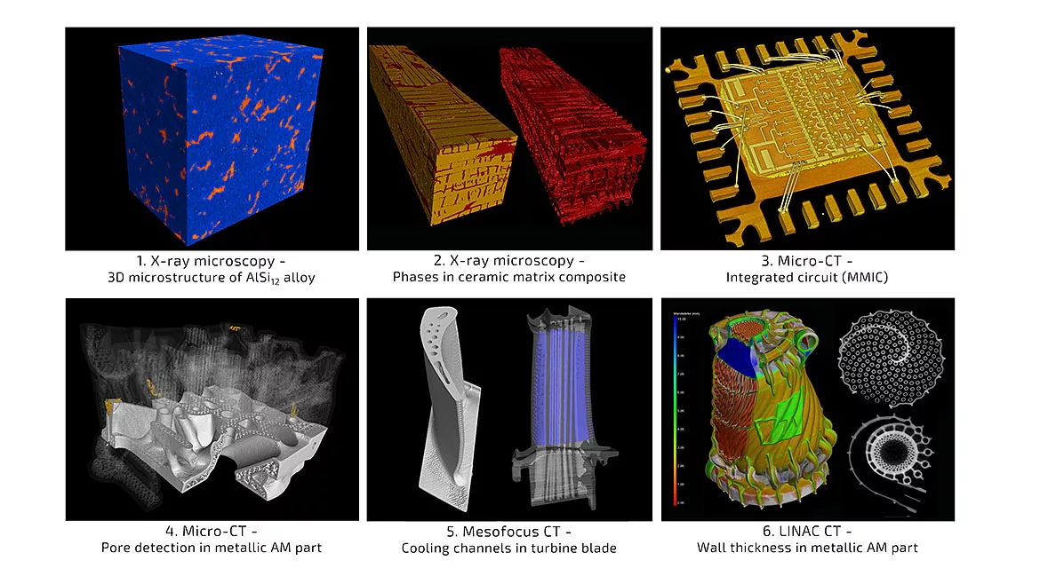

From X-ray Microscopy to LINAC CT: Laboratory CT Technologies and Applications
Industrial CT has become an established tool in the laboratory for the nondestructive inspection and characterization of materials, components, and assemblies across a wide range of industries. From nanometer-scale analyses in material science to high-energy inspections of large, dense components in aerospace, CT systems have evolved into a diverse suite of laboratory solutions. These systems vary by spatial resolution, x-ray source type, detector design, and energy range, offering unmatched versatility for research and quality control.
At the forefront of spatial resolution, laboratory x-ray microscopy (XRM) allows for high-resolution, 3D visualization of internal structures of objects at sub-µm scales. This technique is ideal for high-resolution analysis of microstructures in materials. Typical applications are the characterization of the grain structure, porosity, and phase distribution in metals, ceramics, and composites. Furthermore, electronics benefit from potential material characterization of the advanced packaging technology of semiconductors and electronic assemblies. Another example of use is the development of battery cells, where three-dimensional examinations of electrode coatings can be carried out to optimize coating materials or understand age-related effects in terms of morphology and shape.
Laboratory micro-CT systems (µCT) typically use either transmission x-ray tubes (for small samples with high resolution) or microfocus x-ray tubes, which generate highly focused beams to resolve features in the micron range (1–10 µm). These systems are widely used in material science as well as in industrial component analysis. Examples of applications of µCT include the study of fiber-reinforced composites, such as carbon fiber reinforced polymers (CFRP) or ceramic matrix composites (CMC), which are widely used in aerospace, automotive, energy and defense industries due to their superior mechanical properties and lightweight nature. Micro-CT offers invaluable insights into fiber orientation, distribution, and matrix interaction. In addition, CT imaging allows for the detection of pores, cracks, fiber orientation, and delamination, which are critical for assessing performance and failure risk. µCT brings the quality assurance of lightweight metal castings (e.g. aluminum or magnesium alloys) or plastic components to a new level, by automatically analyzing pores distribution or measuring wall thicknesses and geometry.
For larger components, requiring only moderate resolution, laboratory CT-systems with Minifocus or Mesofocus x-ray tubes are best suited, typically operating with focal spot sizes in the 10–200 µm range. These systems strike a balance between spatial resolution and penetration power, making them ideal for the inspection of dense metallic structures. Mesofocus CT is commonly applied to inspect components such as turbine blades, where internal quality is paramount. CT enables the detection of shrinkage cavities, hot tears, microcracks, and blockages in cooling channels. To ensure the integrity of such components is essential for aerospace and energy sector applications, where failure is not an option.
For particularly large or dense parts, linear accelerator CT (LINAC CT) offers extremely high x-ray energies of up to 9 MeV, delivering sufficient penetration to analyze metal components with wall thicknesses of 350 mm (aluminum), 200 mm (steel) or 150 mm (Ni-based alloy). These systems typically use high-resolution line detectors or high-energy flat panel detectors optimized for radiation-hard environments. The range of applications includes everything from complex measurements of tiny components up to classical nondestructive testing of voluminous objects. Typical components that are examined with LINAC CT include engine blocks and cylinder heads from the automotive industry, larger turbine blades from energy and aerospace sectors and additively manufactured components for rocket engines. The LINAC emits the X-ray beam in pulsed bunches at a high frequency of up to 1 KHz. In combination with fast detector systems, the high pulse rate enables new fields of application in high-speed X-ray imaging, e.g. from running engines, the deployment of airbags.
Various sample images from laboratory CT.
Various sample images from laboratory CT. Image Source: Diondo
Industrial laboratory CT provides a wide range of technologies tailored to different resolutions, sample sizes, and material densities. Each CT class is optimized for a specific resolution–penetration tradeoff, offering versatile, nondestructive analysis from nanostructures to large-scale industrial components.

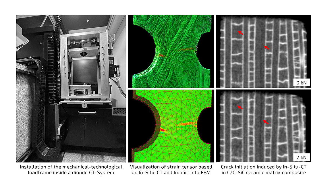

In-Situ-CT: A New Era of Material Testing
A significant advancement in industrial CT was the integration of in-situ testing capabilities. By utilizing a load frame that is capable of applying forces to the object being examined, it is possible to subject samples to tensile, compression or bending loads of up to 20 kN while the CT scan is being performed. This allows it to monitor the internal behavior of the structure of a material or component under realistic service conditions, enabling high-resolution, time-resolved 3D imaging. The value of the so-called In-Situ-CT becomes especially evident when applied to composite materials, such as CFRP and CMC. Their complex internal structures – comprising fibers, matrices, interfaces, and voids – make failure mechanisms highly intricate and often unpredictable. Modern In-Situ-CT setups support a range of mechanical experiments like tensile testing to monitor crack initiation, fiber breakage, and interfacial debonding, compressive testing to capture phenomena like matrix buckling and delamination or bending tests, which are ideal for studying layered structures and interlaminar shear failures. In some cases, these tests can be combined with the use of thermal or environmental chambers to simulate real-world operational stresses.
In industry, In-Situ-CT is increasingly used in design validation, quality control, and failure analysis. Manufacturers can test component prototypes under realistic load conditions nondestructively and examine how they react internally. In critical applications - such as aerospace structural elements or automotive crash components - this allows for early detection of failure-prone zones and contributes to safer, more reliable designs.
In research, In-Situ-CT bridges the gap between experimental testing and computational modelling. The high-resolution 4D datasets (3D over time) allow for the calibration of predictive models, such as finite element simulations (FEM), enabling virtual prototyping and materials-by-design approaches.
In Situ CT system and results of tensile tests on CMC samples.
Diondo In-Situ-CT system and results of tensile tests on CMC samples. Image Source: Diondo
Combined with In-Situ mechanical testing, CT evolves from a pure imaging tool to a dynamic instrument for material characterization, failure analysis, and design validation. This convergence of imaging and testing underscores CT’s growing role in modern engineering, materials science, and industrial innovation.

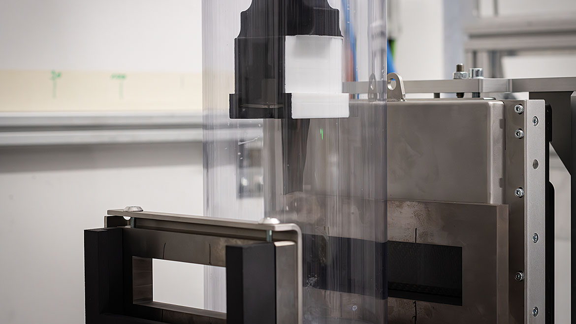

VCb SF Ultra in line CT system
Image of an in-line CT system Image Source: VisiConsult
One of the most pivotal breakthroughs has been the integration of automation and robotics into CT systems. What once required skilled technicians for part placement, scan parameter setup, and data evaluation is increasingly being handled by intelligent machines. Robotic arms can be utilized for loading, unloading, and even dynamic positioning of parts during scanning. This not only ensures consistent and repeatable inspections but also allows for higher throughput by minimizing idle time between scans. The use of programmable robotic cells allows CT systems to operate autonomously for extended periods, even in high-mix production scenarios.
