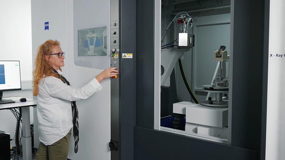

The complete 3D data CT technology captures can be used as a digital twin to deliver key advantages to the aerospace manufacturing industry, including increased speed, repeatability, efficiency, and more accurate defect detection.
The complete 3D data CT technology captures can be used as a digital twin deliver key advantages to the aerospace manufacturing industry, including increased speed, repeatability, efficiency, and more accurate defect detection.
Image Source: ZEISS Industrial Quality Solutions

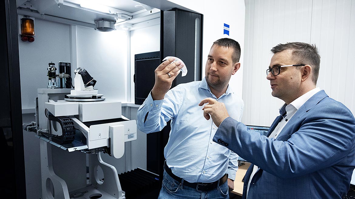

Blade scan with ZEISS VoluMax 9 Titan CT scanner.
Blade scan with ZEISS VoluMax 9 Titan CT scanner. Image Source: ZEISS Industrial Quality Solutions
