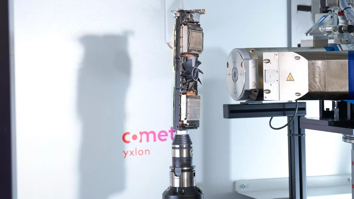

01 QTY 0623 NDT Computed Tomography Interior of industrial CT inspection system
Interior of industrial CT inspection system with large part scan capabilities. | Image source: Comet Yxlon GmbH
