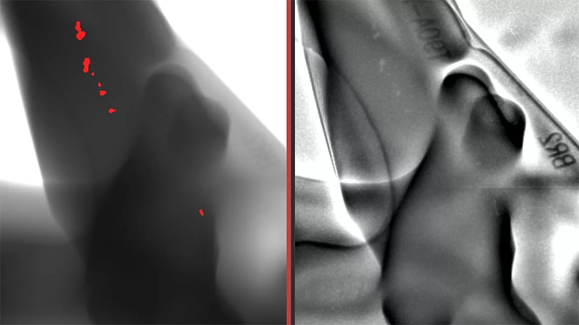

This comparison shows a casting with cavities, which the AI-supported module reliably detects – on the left in the image.
Image Source: VisiConsult X-ray Systems & Solutions GmbH
This comparison shows a casting with cavities, which the AI-supported module reliably detects – on the left in the image. These are otherwise only visible with the help of special image filters – as can be seen on the right – and are difficult to detect. Image Source: VisiConsult X-ray Systems & Solutions GmbH
