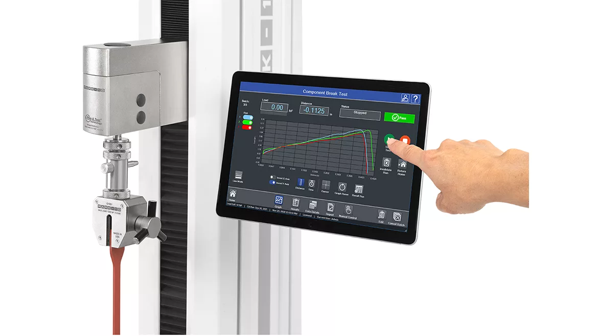

NDT Force measurement system
Force measurement systems can collect data at a high frequency and filter the data to remove the effects of mechanical vibrations. AI algorithms can help predict behaviors and failures based on the data. Source: Mark-10
