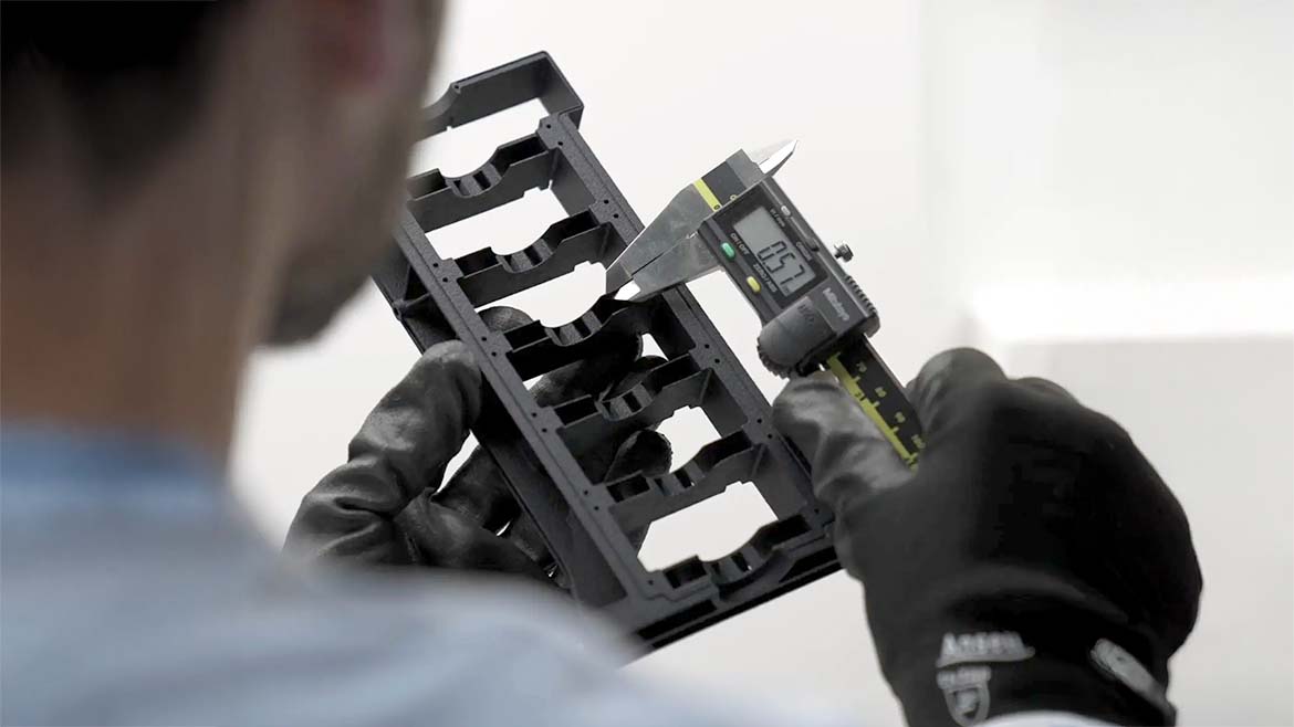

A person using a digital caliper. The person is blurred.

Ask 100 people to define quality in manufacturing, and you’ll get 100 different answers. But in the context of AM for production, quality must mean more than just mechanical strength or material spec. It must include repeatability across production batches, surface finish that meets application needs, version control that ensures the right part gets made every time, and confidence that parts will perform reliably under real-world conditions.
This is where AM still struggles to compete with traditional processes like injection molding. Molded parts benefit from decades of development, rigorous quality systems, and highly predictable outcomes. AM, by comparison, is often treated as a flexible but inconsistent tool.
Too many bureaus still operate like print shops, taking what comes in, slicing it, printing it, and shipping it out. There’s minimal dialogue about how the part will be used, whether it’s been designed for the process, or whether it will actually meet the customer’s functional requirements.

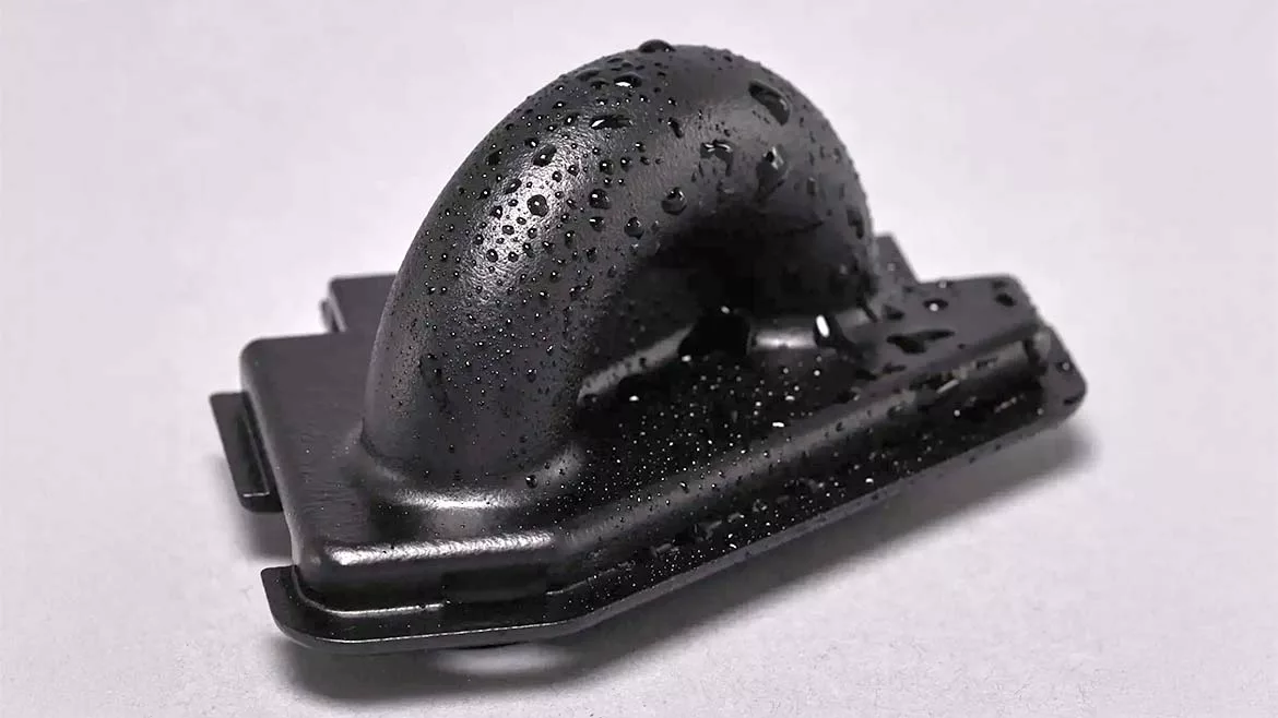

SURFACE FINISH
Another area where quality is often misunderstood is surface finish. It’s easy to dismiss it as aesthetic, but in reality, it affects everything from mechanical properties, porosity, and surface cleanliness to wear resistance, fluid dynamics, and user perception. In applications where parts are visible, handled, or fitted alongside other components, surface finish is a performance factor.
That’s why we have invested heavily in in-house post-processing, including vapor smoothing, shot peening, vibro finishing, and color dyeing, to ensure parts don’t just meet expectations but exceed them. Finishing should never be an after-thought, it’s a vital part of the quality equation.
Too often parts delivered to customers from 3D printing bureaus look unfinished, and that’s because they are. If we expect AM to compete with traditional production, it must deliver a complete part, not just a printed object.
