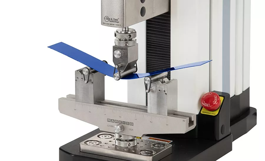

Before selecting equipment, identify the test objective, determine the expected force range, assess sample dimensions, and estimate the sample extension or deformation.
Test Frame
A test frame produces compression and tension forces. Testing speed is regulated to ensure that samples are tested in a consistent manner, for apples-to-apples comparisons.
Test frames are offered in several force capacities, typically from as low as 100 lbF (500 N) up to several tons. For odd-shaped or large samples, column extensions increase the working height and depth. Dual-column test frames offer unlimited depth clearance, though they are typically manufactured for higher force capacities.
Force Sensor
Force sensors (commonly known as load cells) measure tension and compression forces, and are available in many force capacities, from as low as 50 gF (gram-force) full scale to several tons.
Choosing the correct capacity is of paramount importance. A sensor should be used at no less than approximately 5-10% of its range for best accuracy. For example, an application requiring 16 lbF is best served by a 20 lbF capacity model. A 500 lbF sensor would produce lower accuracy and resolution.
Grips And Fixtures
An extensive library of generalized and application-specific grips and fixtures is available by testing machine manufacturers, as well as other manufacturers specializing in fixture design. When a standard solution is not suitable, companies may opt to customize a solution. 3D printing has made fixture design fast and inexpensive in many cases.
