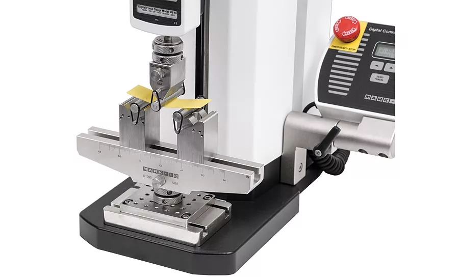

In a three point bend test, an anvil compresses against a sample as it is supported by two anvils in the base fixture. UTMs can produce both tensile and compression forces. Source: Mark-10

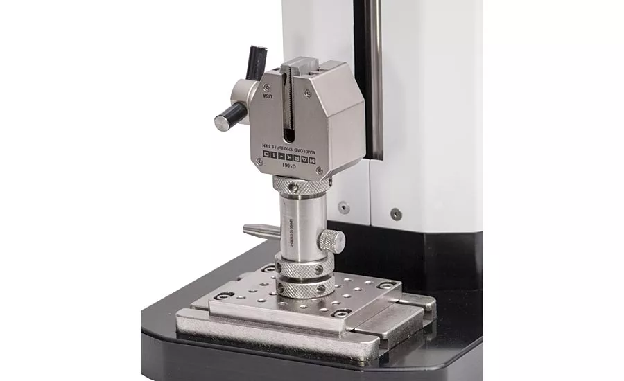

Eye end adapters secure grips to a UTM’s base or load cell, while allowing them to be easily interchanged for different tests. Source: Mark-10

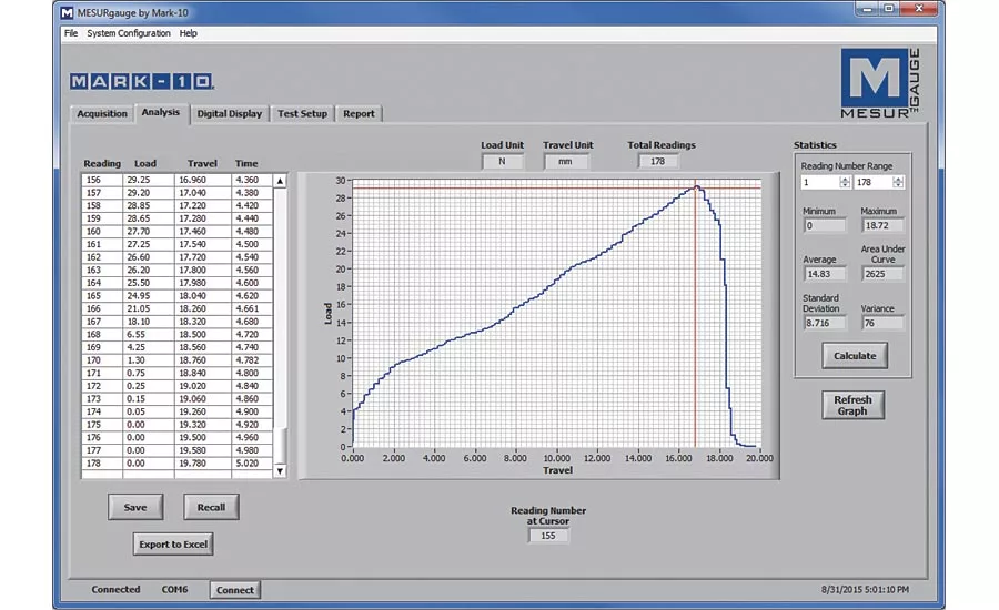

Data analysis software plots force vs. time or force vs. distance data. Statistical calculations are typically offered, along with export to Excel and report templates. Source: Mark-10

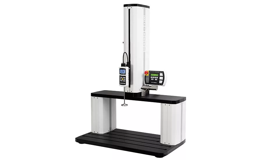

Some UTMs have modular designs, allowing for non-standard mounting. A UTM is shown here with a double-column extension, accommodating larger test samples. Source: Mark-10

UTMs range in force capacity, reflecting a broad range of applications—from peeling open a bag of potato chips to crushing a concrete bridge support. They can be single-columned, generally for lower forces, or twin-columned for higher forces. Most UTMs are driven by one or two lead screws, while some machines utilize hydraulics, especially for cyclic testing applications.

In some cases, raw force and distance data is sufficient, however, in many applications the power of a UTM shines via data collection software, which calculates results in a presentable, useful fashion. For example, an elongation test of an elastomeric strip can be represented by a plot of force vs. distance, or stress vs. strain. As the sample reaches and exceeds its yield strength, the arc of the curve changes until it reaches its ultimate strength, and finally drops to its breaking point. A wealth of information can be derived by analyzing the curve, including spring rate, Young’s Modulus, and many other values. More advanced software packages can automatically calculate these values, and overlay previous test results for comparison purposes.

To address the virtually unlimited number of applications, many standard grips have been developed over the years. Common types include parallel jaw grips for fabrics and films, wedge grips for plastics and metals, compression plates for springs and foams, and others. Most standard grips utilize eye end adapters to mount to load cells, force gages, and machine bases. This method utilizes a pin and jam nuts to prevent the grip from loosening, and provides a quick way of switching grips for different tests.
