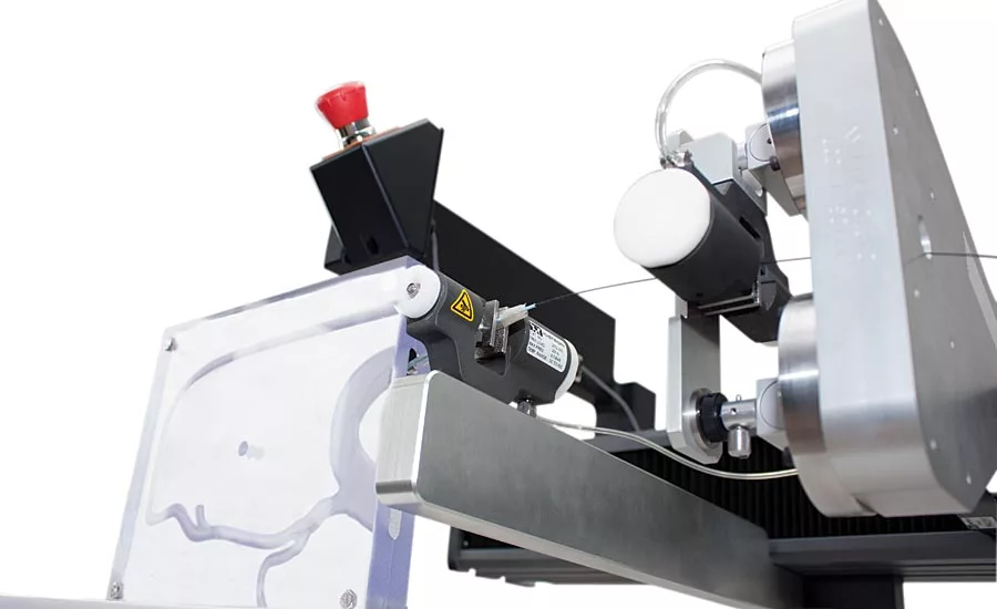

Tortuosity testing systems
Tortuosity testing systems are often used to measure the frictional forces associated with this procedure.

During an angioplasty procedure, a stent is placed into the coronary artery to clear narrowing due to a buildup of plaque or a blood clot. Most commonly, a needle is inserted into the femoral artery, and a guidewire is passed through the needle and guided through the arterial system until reaching the clot or blockage. Next, a flexible catheter is slipped over the guidewire and threaded up to the heart until reaching the site of the clot or blockage. Once the catheter is in place, the guidewire is removed. A second guidewire is then inserted with a collapsed stent on the tip. Many stents are inserted with a balloon which is used to inflate the collapsed stent. Once the balloon is inflated, the stent expands and locks into place, allowing the balloon to collapse and both the guidewire and catheter to be removed from the body. The path through the arterial system in which the guidewire, catheter, and guidewire with the stent must travel is convoluted. The frictional properties of this convoluted path need to be quantified in order to ensure easy and optimal delivery of the stent without harming the patient. Tortuosity testing systems or universal testing systems are often used to measure the frictional forces associated with this procedure. Guidewire and catheter frictional properties can be increased or decreased based on a variety of different lubricants and surface coatings.
