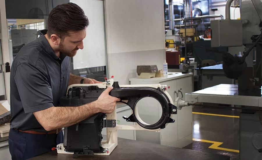

MAHLE engineer working with automotive HVAC assembly and check fixture for fit testing.

3D printed check fixture to verify HVAC assembly’s design, accuracy and stability.

MAHLE, a global automotive parts supplier, needed a check fixture to verify an HVAC assembly’s design, accuracy and stability. The fixture had to be designed, built and shipped from the U.S. to South Korea within a week. Given the timeline and internal 3D printing knowledge and technology gaps, the team turned to Stratasys Direct Manufacturing to help design and build the fixtures. Stratasys Direct and MAHLE worked together to redesign the original part for additive manufacturability and consolidate multiple components into one. Stratasys Direct used the fused deposition modeling (FDM) 3D printing process and ASA, a production-grade thermoplastic with UV stability. In less than a week, MAHLE had a redesigned dimensionally-accurate and stable part shipped across the world—a process that would have taken four to five weeks with conventional manufacturing.
“Moving 3D printing forward within the company has been my primary motivation in doing this project,” says Joe Czach, prototype shop manager at MAHLE. “In the last few weeks, our eyes have been opened in terms of what can be done with it.”
