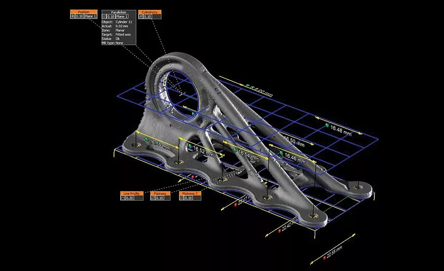

Additive manufacturing (AM) technologies continuously blaze the trail of what’s possible for part design. As such, reliably and accurately inspecting the latest parts has become increasingly complex.
“Complex internal features are the hallmark of additive manufacturing,” says Rob Glassburn, 3D Engineering Solutions VP of operations. “By easing some design restrictions, the inspection becomes more complicated.”
Destructive inspection methods—which have historically been needed to analyze these complicated structures—irrevocably damage expensive parts. They also cause other issues, says Glassburn.
“The issue with destructive methods, aside from losing the expensive parts themselves, is that stresses are also released as you cut into these parts,” he says. “So, the measured features can change in size when sectioned.”
The preferred way to ensure the quality and integrity of the parts is to use industrial computed tomography (CT) scanning, he says, which enables operators to nondestructively visualize all internal structures as well as any internal defects such as trapped powder, delamination, inclusions (from contaminated powder) and any gas porosity from the process. This method of measuring the internal features of AM parts can be combined with traditional inspection methods, he says, such as CMM (when physical contact is allowed with the part), structured light scanning or laser scanning.
“Often, these traditional methods are used to verify and validate the CT scan dimensional scaling when non-metrology grade CT scanning is employed,” he says.
As AM technologies continue to advance and mature, the inspection methods for these unique and complex shapes should change as well.
Application, technology and industry each dictate different combinations of inspection methods, says Philip Sperling, product manager, additive manufacturing, Volume Graphics GmbH.
“While printing complex geometries is simple, the changes these processes make to the underlying microstructure of the material are very complex,” he says. “In the R&D phase, manufacturers need deeper insight into how changes to process parameters affect the part quality so they can refine their processes and validate their simulation tools to iron out issues.”
In this phase, volumetric inspection methods with a high level of detail, such as X-ray based CT, enable a shorter R&D phases and reduce the time to production ramp-up, he says.
“3-D optical metrology systems are ideal for the efficient monitoring of production quality trends, with the addition of CT sampling to understand why defects occur,” he adds. “CT scanning is invaluable for isolating the root cause of negative trends like increased defects in a series of printed parts that are caused by fluctuations in powder quality.”

Mature AM technologies, such as laser or electron beam powder bed fusion, have evolved from prototype and R&D projects into medium-sized serial production, says Sperling. On the shop floor, this shift to serial production demands a different approach to quality inspection that focuses more on spotting trends rather than inspecting single defects or measurement features, he says.
Glassburn says that industrial CT scanning has changed.
“There is a move to metrology grade CT scanning instead of visualization only scanning,” he says. “Early on, just being able to identify internal defects was sufficient. Now that AM manufacturers have developed experience with what is possible with CT scanning, they are asking for traceable dimensional inspections using CT scanning.”
