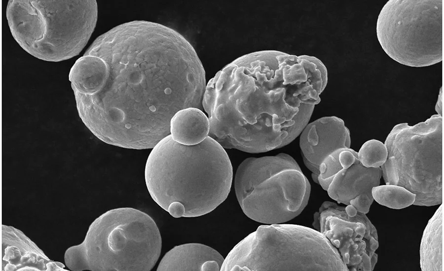

Scanning electron microscopy (SEM)
The powder’s physical properties are an important consideration. Scanning electron microscopy (SEM) can reveal particle shapes and the particle morphology.

The powder’s physical properties are another important consideration. Scanning electron microscopy (SEM) can reveal particle shapes and the particle morphology. Using metal powder with good flow rates, particle size distribution, uniform sizes, morphology, high purity chemistry and low oxygen content tends to create higher quality metal parts.
Powder reuse is common in additive manufacturing because the metal powder is very expensive and only a fraction melts during 3D printing. When the powder is reused, the chemistry can change, some particles become oxidized, and small powder particles that split off during the laser ablation accumulate, creating powder satellites. For this reason, it is important to analyze powder properties to understand how many times a powder can be reused and whether processing parameters may need adjusting to account for changes in the powder chemistry due to the laser melting. Sometimes modifying the virgin powder’s chemistry can improve the properties of the reused powder. Parts made with reused powder should be examined to determine if strength or other mechanical properties differ from those made with virgin powder. This process is time consuming but can yield great benefits. Once the machine has been qualified for the parts using virgin powder the addition of reused powder will yield a higher reliability of consistency.
