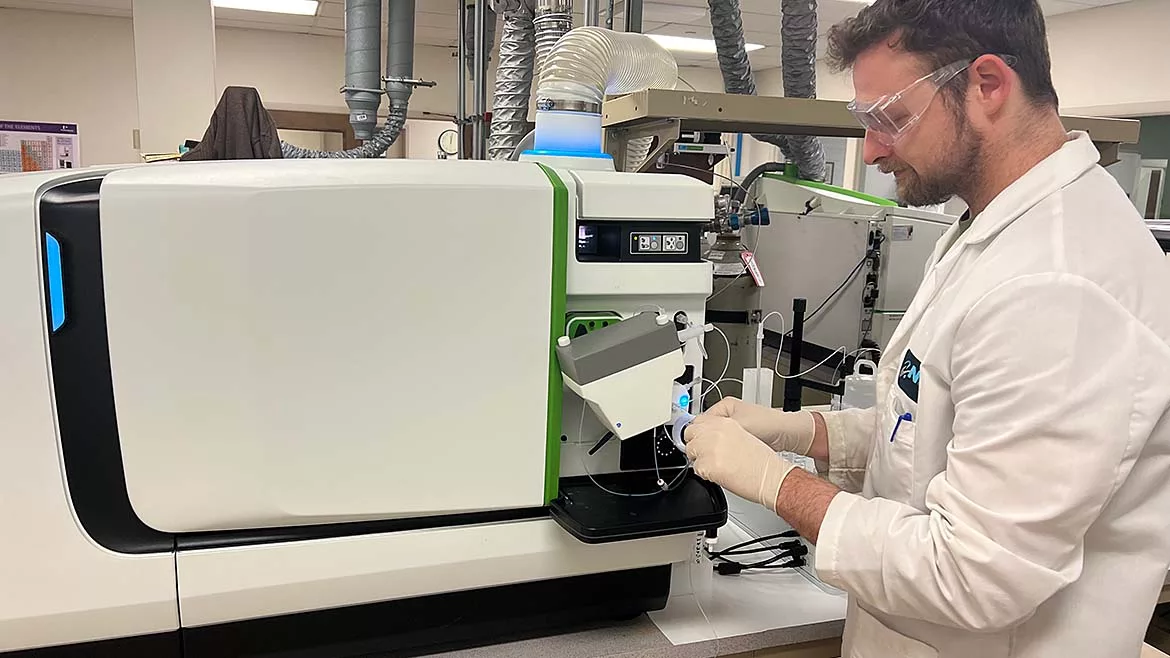

Figure 1: ICP Mass Spectrometer used for chemistry testing of metal powders for additive manufacturing.
Figure 1: ICP Mass Spectrometer used for chemistry testing of metal powders for additive manufacturing. Image Source: NSL

Inductively Coupled Plasma (ICP) is the most broadly applicable and is an analytical chemistry method used to detect and measure elemental composition in a wide range of materials. It covers approximately 70 elements ranging from lithium to bismuth. The metal to be measured is first dissolved into a liquid that is then analyzed for chemical composition using the ICP instrument. Figure 1 shows an image of an ICP mass spectrometer used for chemistry composition testing.
Two other methods are used for light elements like oxygen, carbon, nitrogen, sulfur, or hydrogen. Combustion analysis rapidly decomposes the material in an oxygen-rich gas to measure the carbon and sulfur contents. Inert gas fusion uses a noble gas during heating of a sample to collect the dissolved oxygen, nitrogen, and hydrogen for detection.
By combining the ICP, combustion analysis, and inert gas fusion a full chemistry for metal additive parts and feedstocks can be determined. This analysis can reach detection levels of parts per million, and lower in some cases, for elements like titanium, nickel, niobium, or copper as well as light elements such as oxygen, carbon, hydrogen, or nitrogen.
