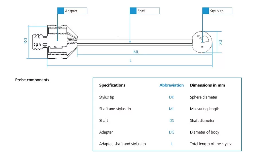

1. The stylus
The stylus is the “tip” of the stylus system and is the first point of contact to the workpiece. Even the construction of the stylus, which comprises the adapter, shaft and stylus tip, impacts the stylus system and thus the measurement result.
Stylus tips
Three factors must be taken into account when choosing a stylus tip: the stylus specifications, and the shape and material of the tip. All features influence each other, which means some stylus shapes are not available in all materials.

Stylus specifications
Depending on the measuring task, there may be different specification requirements for the stylus. The mechanical filtration effect must therefore be considered when selecting the sphere diameter. Compared to the fine structures of the workpiece surface, the stylus tip is relatively large and can thus hardly capture the actual surface roughness. The larger the stylus tip, the larger the filter will be. This should be taken into consideration when selecting the sphere size and, if necessary, a smaller sphere should be selected.

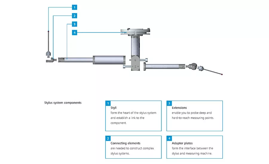

2. Connecting elements
Constructing stylus systems
There are a range of different connecting elements for constructing stylus systems. These can be fixed cubes, angle pieces or end angles.
The standard connecting element is the cube as it allows attachment of several styli in different directions. But there are also freely adjustable rotary elements that enable rotation around the longitudinal axis and support the backlash-free angular adjustment of the stylus system. This means any angle can be set. There are many ways of combining elements. Please observe the following:
A stylus system should have as few connecting elements as possible as every interface, especially in batch measurement mode, can loosen. This can lead to a loss in rigidity. It is preferable to combine several elements in a single element, such as an extension and a cube, when possible.
Moveable elements like knuckle joints increase the flexibility of a stylus system. In contrast to set angle pieces, any angle can be set repeatedly with the knuckle joint. An integrated cone receiver also enables the rotary setting of space angles. This ensures the stylus system remains flexible.
Combining connecting elements that become thinner as they move to the stylus are more rigid and more stable.
For batch measurement mode, fixed connections like milled angle pieces are preferable because the angles do not shift during continuous operation.

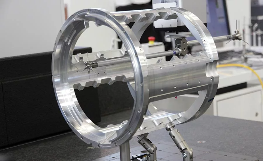

3. Extensions
General Properties

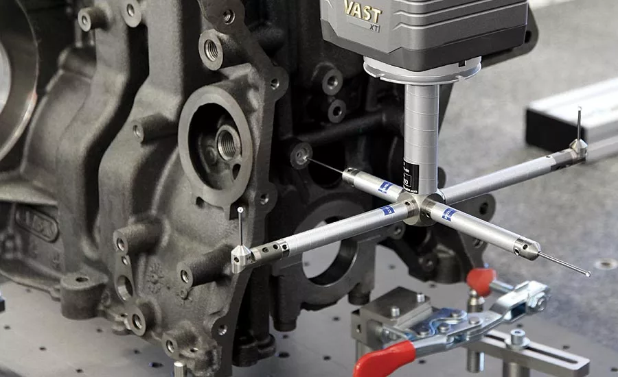

As a rule, all extensions should be as rigid and light as possible.
Extensions help set up complex stylus systems. They enable the setup of long styli to measure hard-to-reach features on a workpiece. Extensions can also be connected directly on the adapter plate to construct the stylus system in z direction. Both extension options support the construction of complex system configurations, which reduces the number of stylus changes.
The selection of suitable stylus and plate extensions is based on the permissible weight, rigidity and thermal stability requirements. Please also bear in mind the guiding principle “thickest to thinnest.” This means the most rigid extension should always be selected for the adapter plate, i.e. a thick one. Thin extensions are only recommended once accessibility close to the workpiece becomes important.
Scanning speed
To achieve the highest possible scanning speed with low form error, select extensions with a large diameter, low weight and high rigidity.

4. Adapter plates
Adapter plates are the central interface between stylus and measuring machine. They are selected to match a particular stylus. Adapter plates from different providers differ only in terms of functions and quality.
