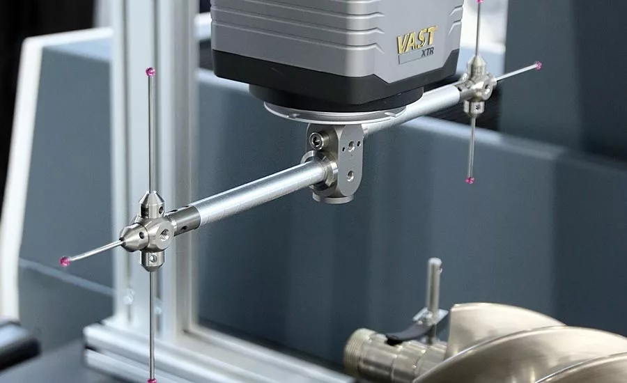

Let’s start with the material typically used for the stylus tips. Most applications default to ruby tips, a good material that offers high accuracy. But there are some things to be aware of. Scanning hard workpieces wears down the surface of the ruby sphere, and scanning soft workpieces creates build-up on the sphere as the tip strips away small amounts of material over the measurement run. Fortunately, quality managers have alternative materials for tips—such as silicon nitride, tungsten carbide and even diamond.
Diamond tips of course are a lot more robust than their ruby tip counterparts. Diamonds have less wear than ruby tips and, consequently, no need to check for wear. There is no need to inspect and clean the stylus tips because no material remains stuck to the sphere’s surface. There are stylus tips made of solid diamond and diamond-coated spheres, or a monolithic diamond coated design. Diamond-coated monolithic tips have a one-piece design.
Secondly, let’s look at the parts connected to that tip. Ideally, you should choose the shortest practical stylus length for your probing application as the more deflection or bending of a stylus the higher the chance of error and reduced accuracy.
This stylus tip is made of solid diamond and diamond-coated spheres.
If an application requires longer extensions, weight can become an issue. The lighter and more rigid the stylus extensions are, the faster the operator can measure without negatively impacting the precision of the system through bending or centrifugal forces. Carbon fiber is the best option for stylus extensions as it is lightweight, has high flexural strength and, because of its thermal stability, eclipses other materials like aluminum, stainless steel, steel, titanium and ceramic.
It’s also important to note there are several stylus tip shapes to consider, depending on your measurement application. Ball tips are the most versatile, as they exhibit the same probing behavior in all scanning directions. While being a bit more challenging to calibrate, disk tips are ideal to measure inner and outer cylinders of boreholes and undercuts, and to localize deep grooves and large boreholes. Cylinder tips are an excellent option for 2D measurements, especially for narrow workpieces like thin sheets. To achieve optimal measurements with a cylinder tip, it is important to ensure that the stylus axis is mechanically and precisely aligned with the feature axis. Like cylinder tips in application, spherical cylinder tips are helpful when trying to determine surface flatness. Half-sphere tips are well-suited for inspecting undercuts and help optimize weight when large spheres are required to complete the required measurement. Finally, star tips are capable of probing from any direction and are frequently used to measure workpiece side surfaces.
