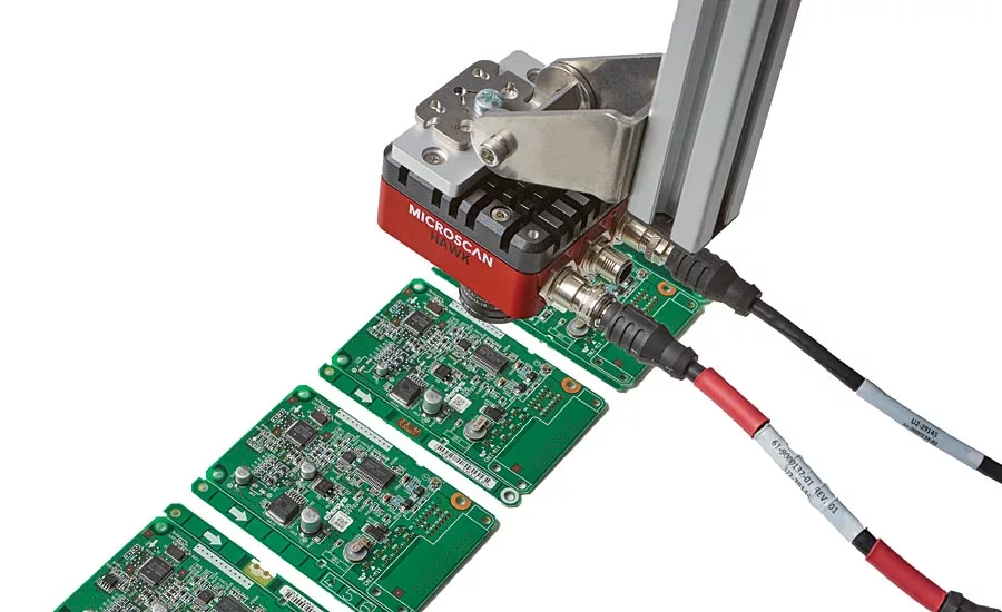

A smart camera locates and captures data from tiny barcodes on a series of PCBs.

The track phase involves scanning codes—usually barcodes in the form of direct part marks (DPMs) or printed labels—to capture data on where each WIP is at any point in time. In general, it’s important to have an advanced barcode-reading system in place to ensure that production isn’t slowed down by no-reads. The vast majority of machine vision smart cameras include a complete barcode reading and barcode quality verification toolkit.
