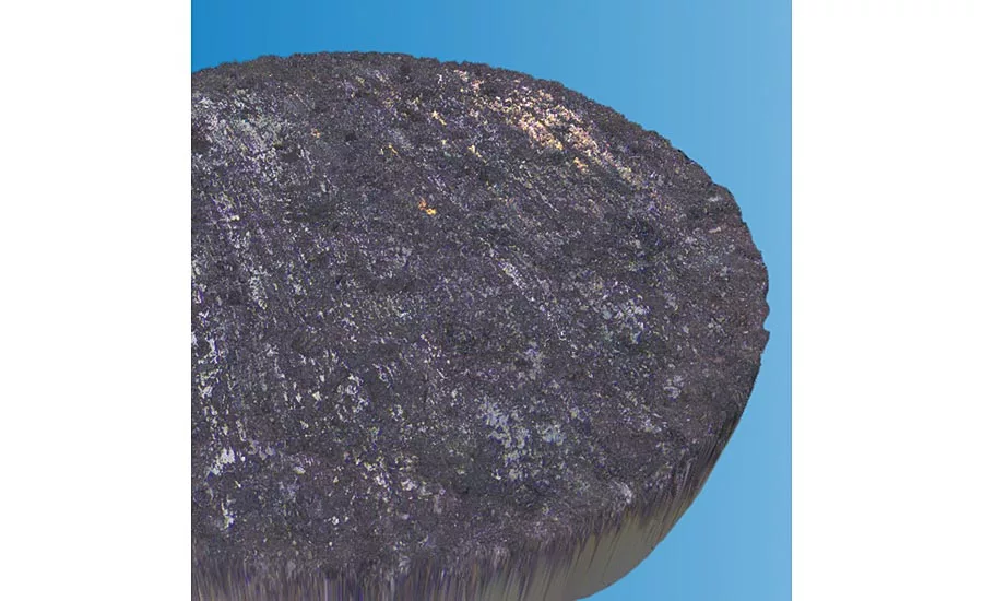

3D optical view
Figure 2. A 3D optical view of a worn brake pad coupon after tribology testing. The color map overlay reveals differences of reflectivity in the material components.

Figure 2 shows an image of a brake test pad after testing. The image surface texture clearly indicates the sliding direction, and wear damage is easily observed. The color image also reveals metallic debris from the brake pad composite material, which can help establish a correlation between material properties and the damage.
