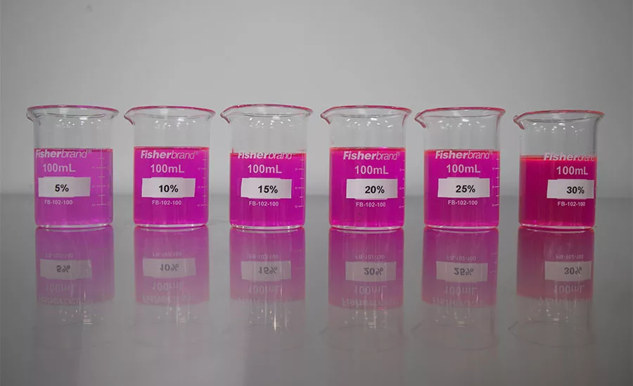

This can be accomplished by preparing known concentrations of hydrophilic emulsifier, measuring and recording refractometer readings of the known concentrations, and plotting a graph of the refractometer readings vs. known concentrations.
Prepare several known concentrations of hydrophilic emulsifier in water. For example, if hydrophilic emulsifier is used at 20% concentration, prepare known emulsifier concentrations of 5%, 10%, 15%, 20%, 25% and 30%.

Preparing the known concentration samples
Supplies needed are unused hydrophilic emulsifier concentrate as supplied by manufacturer, graduated cylinder, and several beakers. Alternate method: volumetric pipets and volumetric flasks may be used in place of graduated cylinders and beakers.
For consistency, use the same source of water that will be used to prepare the hydrophilic emulsifier solution in the penetrant inspection line. For example, if tap water is used to prepare hydrophilic emulsifier solution in the penetrant inspection line, use tap water when preparing the known concentrations.
The same calibrated refractometer should be used to measure the known concentration samples as is used to test the hydrophilic emulsifier concentration at makeup and weekly.
Preparing 100 ml of each known concentration will keep the calculations simple. Using a 100 ml graduated cylinder, prepare the 5% emulsifier solution by adding 5 ml of hydrophilic emulsifier to 95 ml of water for a total of 100 ml of 5% emulsifier solution. Adding the hydrophilic emulsifier to the water will facilitate the mixing of the solution. Pour the 5% emulsifier solution into a labeled beaker. Follow this procedure to prepare the remaining known emulsifier concentrations.
Measure and record the refractive index of each prepared emulsifier concentration using the same calibrated refractometer.

Preparing a Concentration Chart
Prepare a concentration chart by plotting the refractive index readings vs. the known concentrations. Draw a best fit line. This chart may be used to determine unknown concentrations simply by determining where the refractive index reading intercepts the best fit line and following down to the percent concentration on the graph. The equation of the line could also be determined, and each refractive index reading could be plugged into the equation of the line to determine the concentration.
