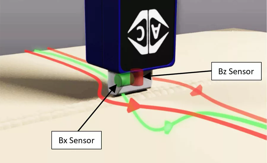

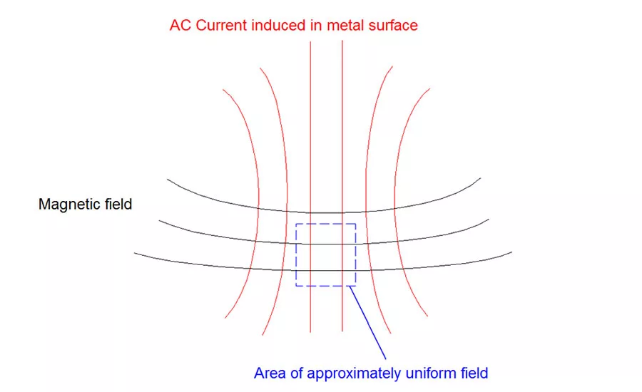

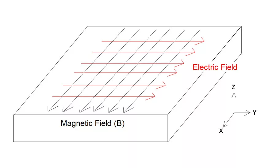

ACFM locally induces a uniform current into the component under test and measures the density of the magnetic flux over the component surface. The electric field is typically induced at a frequency of 5 kHz which, on carbon steel, results in the currents being confined to a thin skin at the material’s surface. Surface-breaking defects perturb the induced current, thus the magnetic flux density. ACFM measures two components of the magnetic flux density: one offers information about the position of defect ends (ergo the defect’s length). The second component provides the aspect ratio (and hence depth) of the defect. The components combined to confirm defect presence and, with a sizing algorithm developed from theoretical models, establish surface length and depth.
The primary direction of induced currents is designated as the Y axis, while the direction of the associated magnetic field in and immediately over the surface is designated as the X axis (as shown in Figure 2).
When the component under test is devoid of defects, the current flows along the Y axis and the magnetic field along the X axis. The magnetic field’s Y and Z components (designated By and Bz) are zero, while the X component (Bx) is proportional to the magnitude of the electric current.

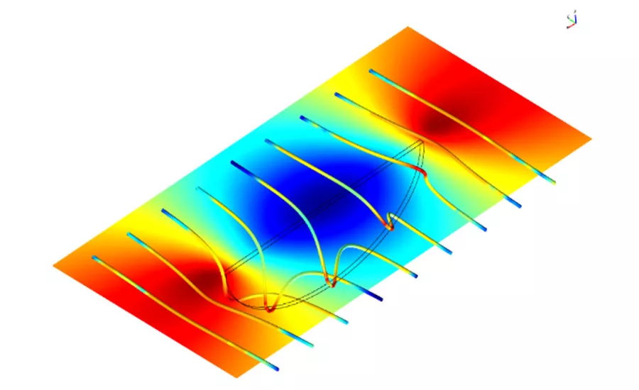

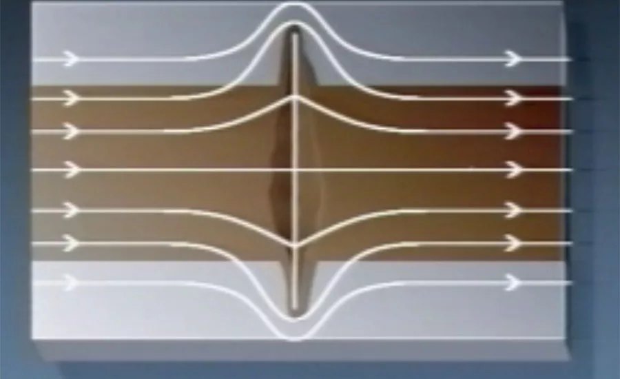

When a linear surface-breaking defect is present in the component under test along the X axis, cutting across the electric current lines, the current is forced to flow around and under the defect’s ends.
As it flows under the defect, some of the current is forced away from the surface. This reduces the strength of the magnetic field in the middle of the defect (blue in Figure 3). Some of the current flows around the ends of the defect, strengthening the magnetic field at the ends (red in Figure 3). As it does, a partly circular flow appears. This rotation around the ends of the crack produces a measurable, non-zero Bz.

The basic ACFM probe contains a minimum of three elements:
  • Magnetic field inducer
  • Magnetic sensor to measure flux density along the X axis
  • Magnetic sensor to measure flux density along the Z axis

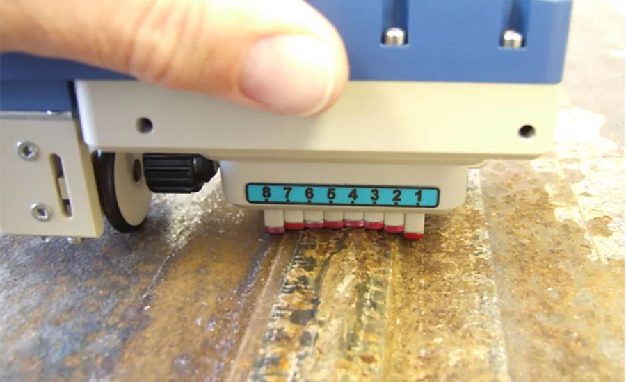

Basic ACFM probes can only inspect a narrow strip 10–15 mm (0.4–0.6 inch) wide, centered on the probe sensors.

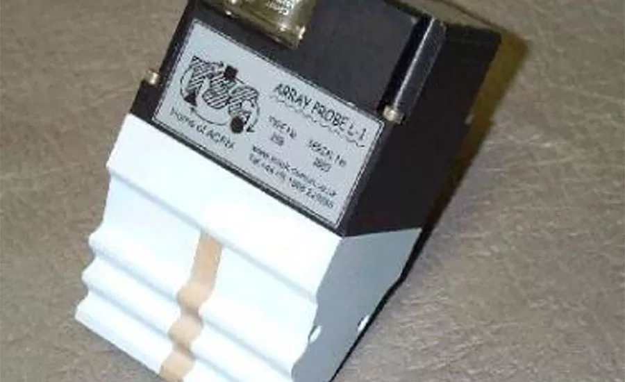

Array ACFM Probes
To inspect wider areas in one pass, array ACFM probes are engineered to contain several sensor pairs adjacent to each other. The sensor array profile can have multiple configurations.
Some array probes feature a Y-field inducer perpendicular to the primary, X-field inducer, and an additional By sensor, making them capable of inspecting in two orthogonal directions simultaneously to detect and size defects in any direction.

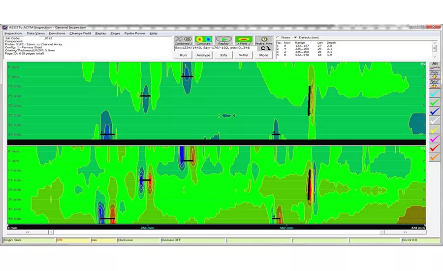

Array data can be displayed as traditional trace plots or as C-scans, where red peaks and blue troughs appear against a green background level (See Figure 8).

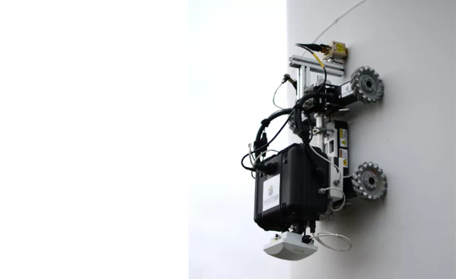

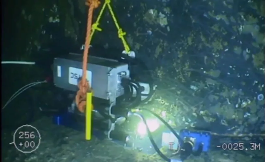

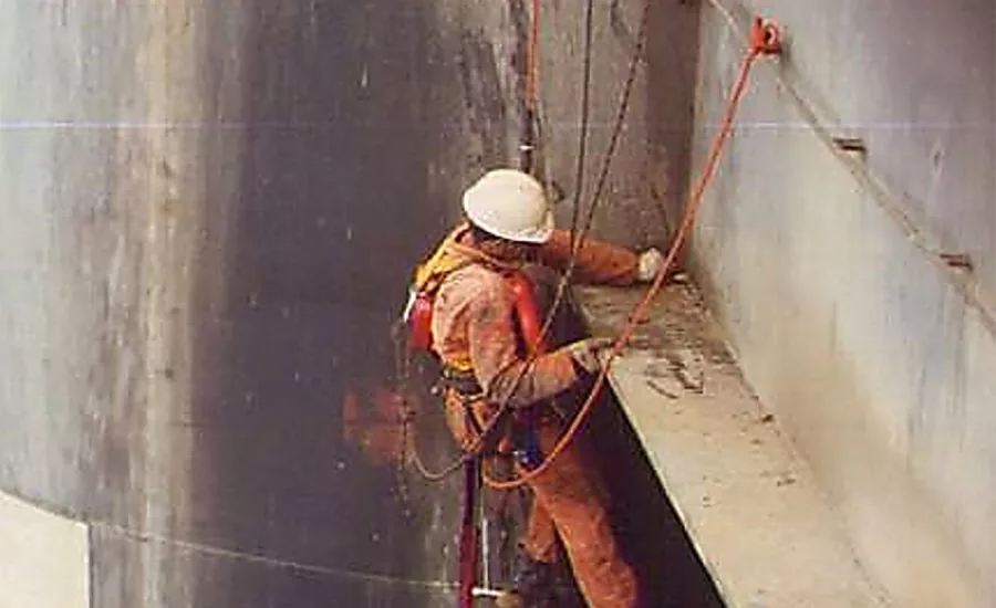

A number of industries use ACFM to inspect welded connections for surface-breaking defects. Because array ACFM probes offer a wide coverage and relative tolerance to liftoff, they can be part of remotely deployed solutions, such as scanners and crawlers. Applications where this is useful are where direct human access is difficult, unsafe, or costly.
