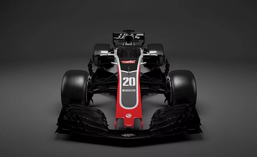

With its racing debut in 2016, Haas F1 Team is the first American Formula One team to hit the circuit since 1986. Founded by Gene Haas, the team is based in Kannapolis, NC. Haas is the founder of Haas Automation, the largest CNC machine tool builder in North America, and he is the chairman of Haas F1 Team.
“Haas F1 Team gives new meaning to the term rapid development, especially when you consider the fact that the effort is truly global. Machined parts, mold layups and assemblies are done in the U.S., engine development and wind tunnel testing come out of Italy, and team logistics are handled in England,” Haas said. “Car development in Formula One takes place at hyper-speed compared to most industry timelines. Parts need to be made in days, not weeks, and they need to be right the first time. At the end of the day, each race is really a metaphor for the development process to get there—speed, precision, quality and no room for error.”
Within the rules of Formula One, there are certain components you are allowed to buy, but for the most part, cars are developed, manufactured and assembled by the team. This includes all the aerodynamic elements, machined parts, molded carbon fiber parts, and even garage tools and pit equipment. That’s right, these cars are so complicated and compact you can’t even work on them without specialized equipment. Haas F1 Team designs and manufactures special tools and fixtures, including car jacks, wheel sockets, camera mounts, tire dollies and much more.
