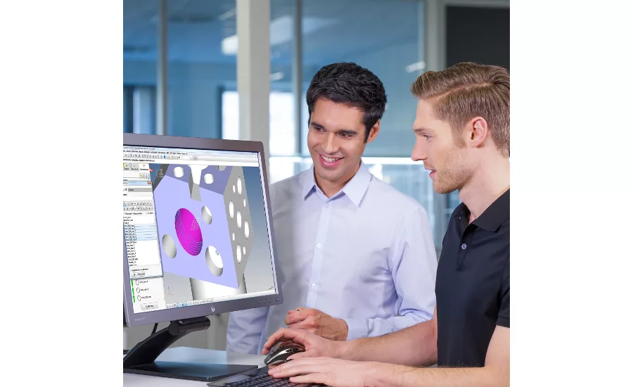

ZEISS CALYPSO NZDI provides a uniform software platform. Source: Zeiss Industrial Quality Solutions

To streamline workflows, customers often request software that can run on all of their metrology devices, says Scott Lowen, software product manager at ZEISS Industrial Quality Solutions. Therefore, ZEISS offers a common software platform called ZEISS CALYPSO NZDI that can work on non-ZEISS machines, controllers, and probe heads.
According to Lowen, a common software confers many benefits to the end-user.
Direct Connection
Non-ZEISS Direct Interfaces (NZDIs) are direct connections to a system’s existing controllers. This means that there is no need to remove an existing software, part program, or computer from a setup that already works for the end-user.
Instead, CALYPSO software can be installed in parallel with an existing setup, with no hardware retrofits, alterations, or disruptions to that machine. Two software packages can run on the same machine, and the end-user can switch between CALYPSO and existing software. CALYPSO also will read the same calibration data as the OEM software, so no additional calibration is required.
As an alternative to the NZDI method, ZEISS can add CALYSO to a non-ZEISS CMM using the I++DME specification. “That’s a standard that is put in place to allow connectivity of a metrology software to a CMM controller,” says Lowen. This means that a client and server relationship can be used to communicate information between a CMM and CALYPSO. The non-ZEISS CMM can connect to a I++DME Server and ZEISS can provide CALYPSO with a I++ DME client.
