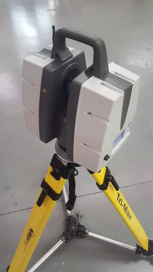

While donned in full radiation protection suits, Exact Metrology personnel scanned piping in over two dozen rooms throughout the power plant utilizing Leica HDS scanners. The Leica scanners were capable of capturing full-volume, 360-degree 3D point clouds in about three minutes. Some rooms only required a single setup, which resulted in minimal exposure times to the harsh nuclear environment. Once a scan is initiated, the data acquisition is completely automated allowing the Metrologist to retreat to low dose areas while critical data continues to be captured by the device. Once scanning was completed, the multiple scan setups were stitched together to form one large point cloud. This allowed the users to extract data from any section of the pipe run and from any perspective. Complex software algorithms then provided a function to extract all pipe sizes, centerline and position even when only part of the pipes were scanned. As an added benefit, the dense point cloud obtained was able to reveal areas of crystallization, which indicated that leaks in the pipes were already in progress.
