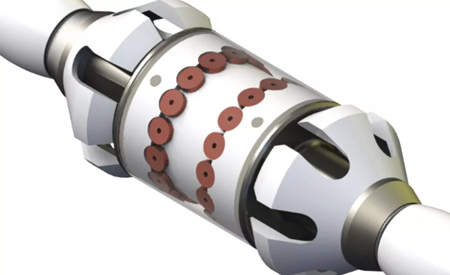

The two rings of coils on this X-Probe are an example of a multi-coil array probe.
The two rings of coils on this X-Probe are an example of a multi-coil array probe. This probe is used to inspect tubing at nuclear steam generators, where speed and detection accuracy are critical for reducing costs as well as radiation dose.

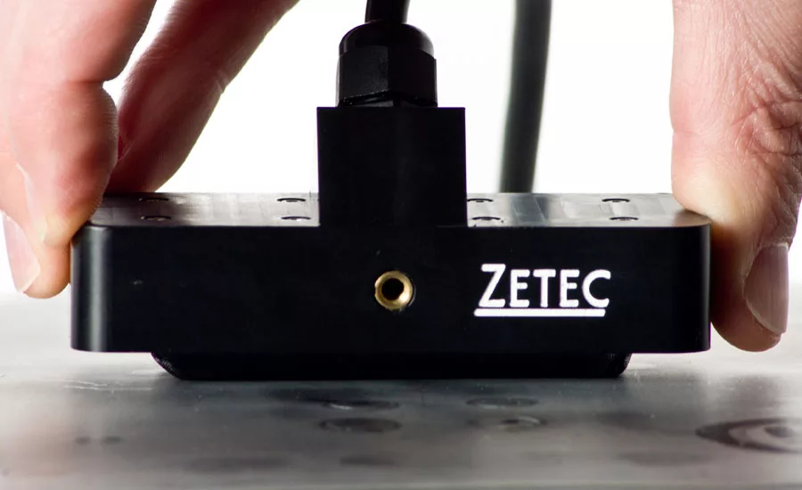

This surface array probe is designed to cover a two-inch wide inspection area in a single pass
This surface array probe is designed to cover a two-inch wide inspection area in a single pass, including on non-flat surfaces.

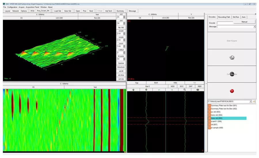

The right software can provide fast, accurate data acquisition
While the multi-coil array probe is producing a constant stream of eddy current data, the right software can provide fast, accurate data acquisition, advanced analysis, and reporting, while providing an increase in probability of detection.
