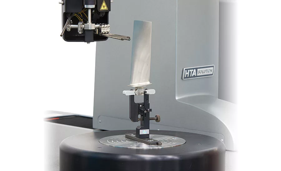

This sensor combined with a rotary table offers up to 5 times improved cycle time than traditional tactile methods of compressor blades.

This noncontact optical sensing range combines speed, accessibility and accuracy for distance measurement. Interferometric measurement offers the accuracy and reliability comparable to tactile scanning probes, at higher scanning speeds, increased measurement range and the general optical advantage of noncontact measurements. This is the next-gen alternative for high-precision tactile measurements when speed is important, parts are difficult to access with tactile probes, or when parts may deform or be damaged by touch probing.
