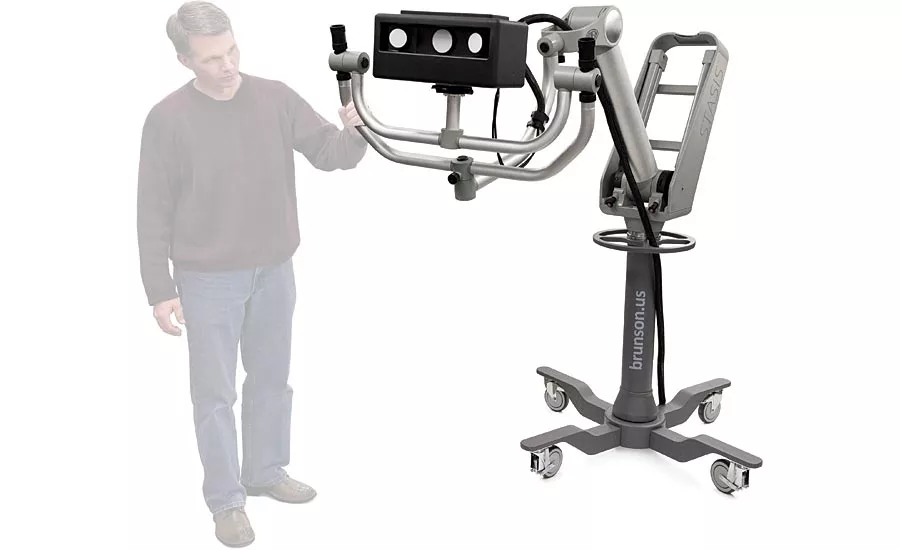

Brunson Instrument Company will launch STASIS, a mobile, agile scanning instrument positioner at Control 2019. The first-of-its-kind product allows all brands of scanning instruments up to 35 pounds to be positioned quickly and steadily anywhere within a 3-meter horizontal- and 2.1-meter vertical-range atop a sturdy, 4-wheeled Brunson base. Remarkably flexible and steady, STASIS is a carefully counter-balanced, gimbal-style mount that allows the operator to move from position to position, easily capturing shot after shot with minimal dwell time.
Your scanner never moved so easily—or so steadily. STASIS deploys a precisely counter-balanced, gimbal-style mount that reaches just under 10’ (3.02m) in horizontal range, with a vertical reach that extends to 96” (2.44m) above the floor.
The hand-controlled STASIS positioner allows the operator to very simply adjust the roll, pitch and yaw for each shot and provides an almost 10’ horizontal range. STASIS’ vertical span extends from a position over 8’ high to as low as 14” from the floor, all without moving the base.
With a carriage assembly design that balances around the scanner’s center of gravity, STASIS’ Counterbalanced Support System (patent pending), moves the metrology equipment easily and settles in place very quickly, allowing for rapid and subtle scanner placement, and diminished time between shots.
