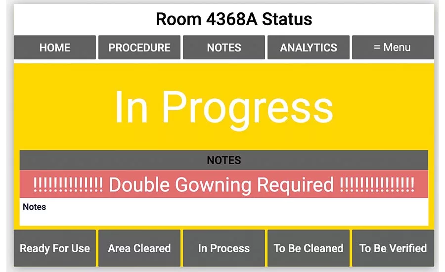

An app displaying room status is stationed outside every production room, allowing teams to view and record progress in real time.

This was precisely the challenge facing a consultant I worked with recently, who preferred to remain anonymous. His task was to run a multi-room production facility more effectively while remaining compliant with FDA guidelines. Many of the sources of inefficiency and low-visibility were a result of the facility’s reliance on paper. While the paper logs used throughout the client’s operation were sufficient to demonstrate compliance, they weren’t providing enough information to guide improvement efforts. As the consultant noted, “We scan all our paper logs into a computer for regulatory purposes, but it’s difficult to use for continuous improvement since the data cannot be easily analyzed and times are not tracked.”
The consultant’s solution was to develop manufacturing applications using a no code digital platform to track the status of production rooms. Rather than using traditional visual indicators such as colored magnets, this consultant is creating apps that let team members track progress in each room in real time. Their entries will be stored automatically and available immediately. When rooms are ready for cleaning or validation, the app will send a signal notifying the appropriate team they are needed.
This system allows this consultant’s client to have the best of both worlds. Because the apps and databases run in parallel to prescribed compliance requirements, the manufacturer can continue to improve and refine their processes without needing to recertify the entire production process. The consultant summarized, “Team members will continue to write in the logbooks in each room in order to comply with FDA standards. However, since the apps running on the iPads are simply used for operational efficiency, they do not need to comply with 21 CFR part 11 guidelines.”
