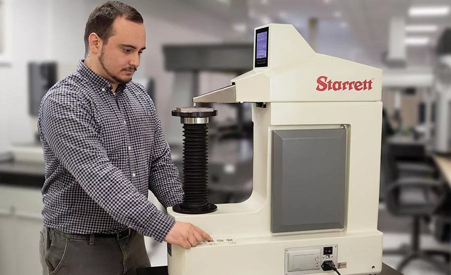

automatic hardness tester
This automatic hardness tester has an automated Z-Axis. The user simply presses the START key, and the entire test process is automatically completed.

When testing the hardness of carbon steel, alloy steel, cast iron, non-ferrous metals and engineering plastics, digital Rockwell benchtop hardness testers can be used to directly measure the most popular regular Rockwell hardness scales and can quickly convert that hardness value into HB, HV, HK and many other scales. Desirable hardness tester features include the ability to obtain ultra-precise results, a wide measuring range, and scale/ selectable test force capabilities. Also, automatic main test force loading/unloading, a high resolution digital display and USB data storage are all very advantageous.
A user-friendly touchscreen interface can speed operations and the ability to use USB output to a flash drive is excellent for data mobility. There are options to apply the weight load such as on digital systems that use weights to apply the load or use a closed loop load cell to apply the weight load. The latter affords greater precision and repeatability. With a weight loaded system, the level of the machine is of great importance, so that the weights drop correctly. This is a less critical matter when using a load cell system.
hardness tester
This hardness tester with fully automated load/unload procedures offers highly sensitive and accurate readings.
Conforming to ASTM E-18 Superficial Rockwell Hardness standards, hardness testers in this category offer excellent repeatability in all superficial Rockwell hardness scales. Superficial Rockwell hardness testing is designed for very thin and soft workpieces. The systems are ideally suited for a wide range of environments including inspection labs, heat treat facilities, tool rooms, workshops and laboratories. For more versatility, twin hardness testers are capable of testing in all of the regular Rockwell and superficial Rockwell hardness scales.
Dolphin nose systems allow for the hardness testing of inner, as well as exterior, diameters. The systems are generally larger in size than other bench Rockwell systems, offering greater testing heights and depths. Dolphin nose models offer a manual handle that activates the preload system, or an advanced Auto Z-axis preload system. Using the Auto Z-axis preload system, after placing the workpiece in testing position, the operator only needs to press the start button for the machine to complete the testing process.
