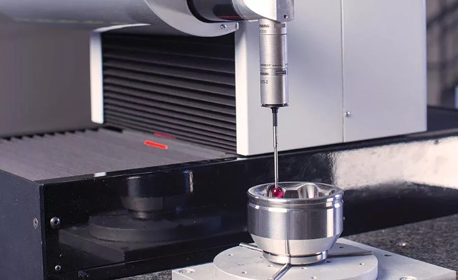

Flexible gaging
Flexible gaging can provide an alternative to the lab CMM and relieve a bottleneck without sacrificing accuracy.
5. Resource Utilization. Even more critical than space is the utilization of critical equipment. Often a CMM or multiple CMMs carry the measurement load, and are typically placed in the lab. The CMM is also often a bottleneck for measurements. Although accurate, they tend to be slow and require a controlled environment, making them less accessible to the shop floor. Flexible gaging can provide an alternative to the lab CMM and relieve a bottleneck without sacrificing accuracy, and possibly providing faster measurements at the process location.
