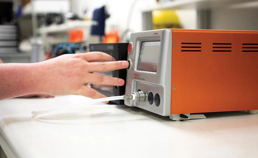

An object with one port or opening, such as a catheter, can be directly connected to the front port of a leak tester without a fixture.
How a pressure decay test works
During a pressure decay test, a product is attached to a leak test system and filled with air. Once pressurized, the air source is closed off and the pressure is allowed to settle. During the test any decrease in air pressure over time signifies a leak.
