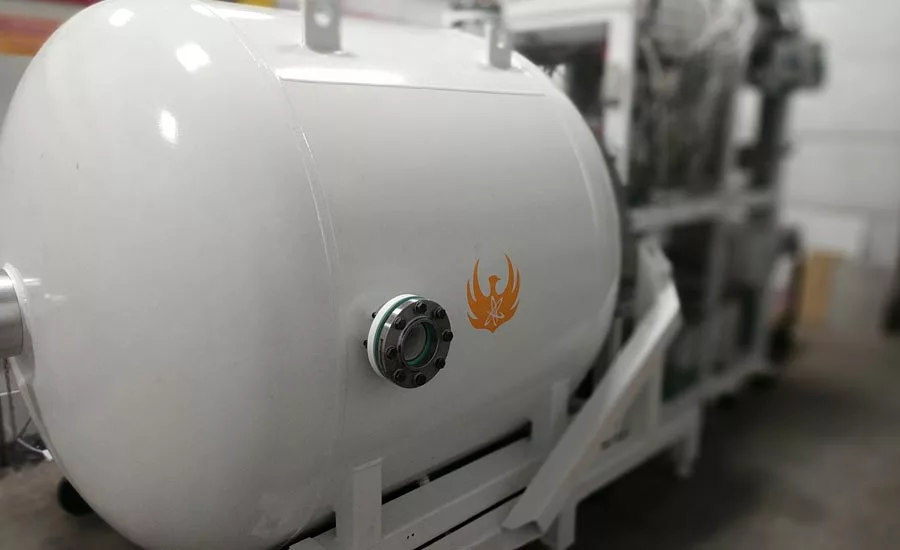

accelerator-based neutron generator
An accelerator-based neutron generator that can be used for neutron imaging.
