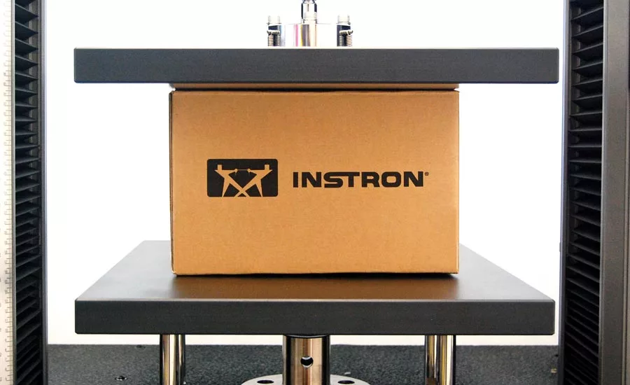

box compression test
This is an example of a box compression test. The various box sizes require complementary platens to accommodate the geometry and force capacities.

Crushing is the most common mode of failure for boxes, and more importantly the most common cause of damage to the contents of a box. Resistance to crushing is evaluated by performing the ECT test on a universal testing machine using compressive forces. The major challenge associated with this testing is the need for extreme parallelism between the compression platens. This can be accomplished by using guide columns connecting the upper and lower platens, which prevents any sort of bending movement of the platens and directs all applied compressive load directly to the test specimen. The guide columns will also integrate linear bearings to prevent any unwanted friction and maintain accurate load readings.

Simply testing the wall material in compression does not give a complete picture of the structural integrity of the box, nor does it evaluate the box closure design. To better simulate real world usage, a full box compression test is often performed to compensate for variations due to the construction of the box. Box size is generally the most challenging factor in performing this testing, so any supplier of universal testing machines must be able to provide flexible solutions including extra wide machines and oversized compression platens. When working with extra wide or tall machines, the overall system stiffness is important to ensure the aligned loading of the boxes as well as accurate crosshead displacement readings.
