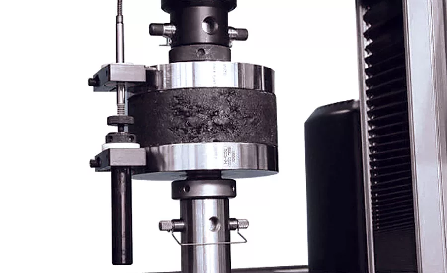

Compression testing on a cylindrical specimen.

In general, a universal testing machine is a piece of equipment with a moving crosshead, which raises or lowers depending on the test being performed. Attached to the moving crosshead is a load cell. This is used to measure the amount of force or load that is being applied to a test specimen in real time. The term “universal” in the name refers to the ability to place any number of fixtures within the load string. A fixture can refer to tensile grips, compression platens, bend fixtures, or more application specific devices such as peel or puncture fixtures. Being able to interchange the load string allows a simple device to perform hundreds or even thousands of testing variations.

An encoder is a device which measures the movement of the UTM crosshead, which is equated to specimen displacement. This is the simplest, but not necessarily the most accurate way to measure displacement. Extremely stiff materials like hardened steels and carbon fiber exhibit high forces and low strains. While under load, the entire UTM experiences minute deflections on the micron level which are being accounted for in the encoder displacement. This can be problematic for achieving accurate results on materials which only deflect on similarly small scales. An extensometer also measures specimen movement; however, it is usually attached directly to the specimen for improved measurement accuracy.
