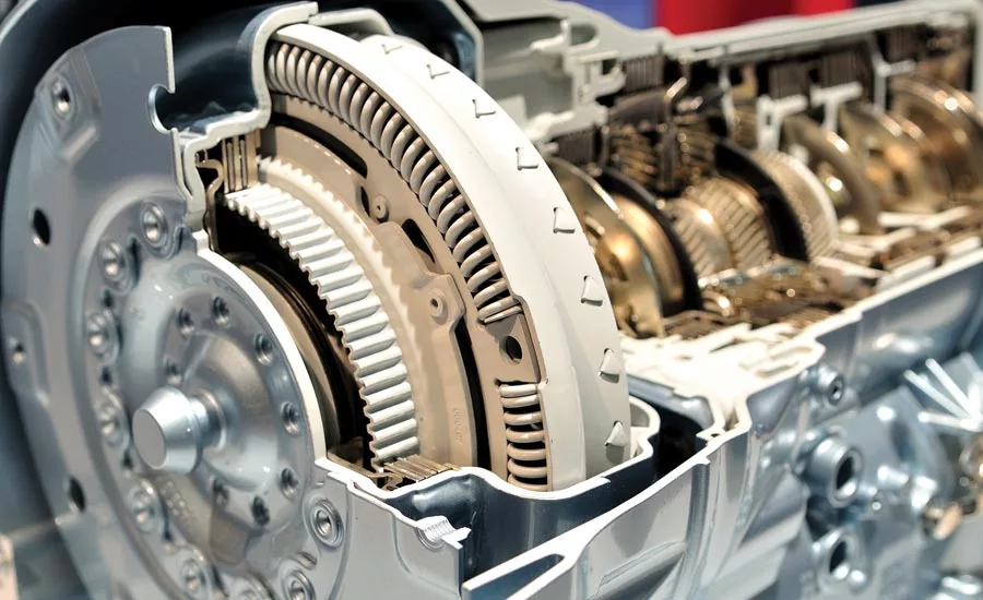

Figure 1: Electroless nickel plating is widely used in the automotive industry

One of the key benefits of the nickel-phosphorus coating is that it provides a very consistent thickness that isn't dependent on part geometry. Electroless nickel plating can reach all hidden surfaces to offer complete coating coverage even on the most intricate parts. An additional benefit is that electroless nickel plating can be applied to both conductive and non-conductive materials, meaning it can be used also for a wide range of non-metallic substrates such as plastic, textiles, wood, and paper. Today, electroless nickel coating is used in many industries such as automotive (e.g. bearings and gear assemblies), electronics (e.g. printed circuit boards and connectors) and it continues to be adopted into new industries.
