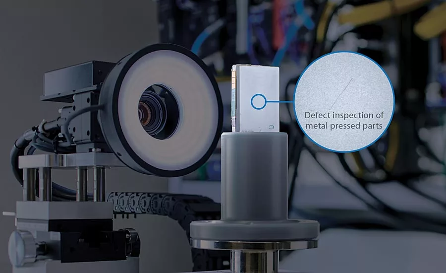

Pre-trained AI scratch detection tools
Image above: Pre-trained AI scratch detection tools in this vision system easily capture subtle defects on all types of surfaces.

To reliably detect scratches, a vision system must be able to distinguish the actual defect from noise or other patterns on the product surface.
