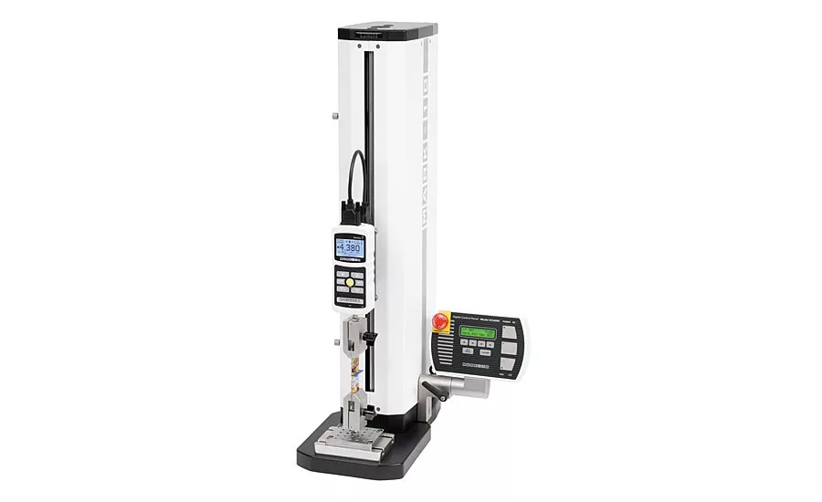

Benchtop Systems
A force gage or load cell can be mounted to a test stand, ensuring axial alignment with the sample and providing repeatable test speed. Test stands can be manually operated via hand wheel or lever, or motorized. While manual test stands are generally inexpensive and portable, speed cannot be guaranteed, thus limiting their ability to conform to test methods requiring specific test speeds.
In addition to regulating speed, motorized test stands can be programmed to perform more advanced functions, such as auto-reversing at a force limit, distance limit, or sample break. It can also cycle continuously between limits, for fatigue testing, and maintain a load over a period of time, for durability analysis.
