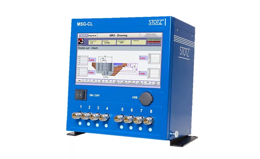

So, let us dive into how air gaging can be used to measure some of these other form requirements. Before I get into how specifically these gages are designed and work, I should state that a lot of these form dimensions are reliant on the display unit or operator to keep track of the MAX and MIN and then the delta of MAX-MIN. A lot of the more modern display units will keep track of this for you, making these calculations quite simple to achieve. As an example: Roundness would require you to know the MAX and the MIN value and do simple math of MAX-MIN to achieve your roundness dimension. As stated above, the display unit can keep track of this for you or the operator can watch on the screen and visually see the MAX and the MIN and do the math in their head.

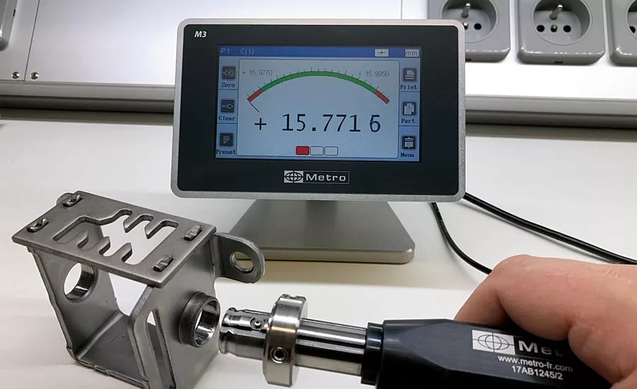

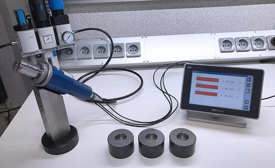

We will start with how to calculate roundness. The great thing about this requirement is that it requires no special equipment besides the air probe or ring that you are already using to check the diameter. It simply requires you to rotate the part or gage 180 degrees and either have the device or the operator keep track of the MAX and the MIN and MAX-MIN for your roundness calculation. I should state that this works best on a standard 2-jet gage. If you have more jets than that, you are going to average the roundness and underreport the actual deviation. The reason for rotating 180 degrees is because with a 2-jet gage, it is averaging in that one plane and once you have rotated 180 degrees, you are simply measuring the same thing a second time.

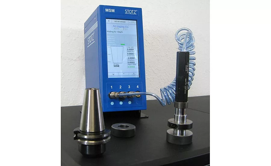

Measuring the taper on a part is accomplished by having at least two separate levels of air jets. There would be one level on the top of the part and another separate set of jets on the bottom of the taper. The two diameter sizes are reported and by inputting the distance between the two levels, the display unit can calculate the degrees, minutes, seconds of the taper using trigonometry calculations. With higher-level display units, you can also calculate the diameter at the face or finding the location on the taper where a certain diameter size is at.

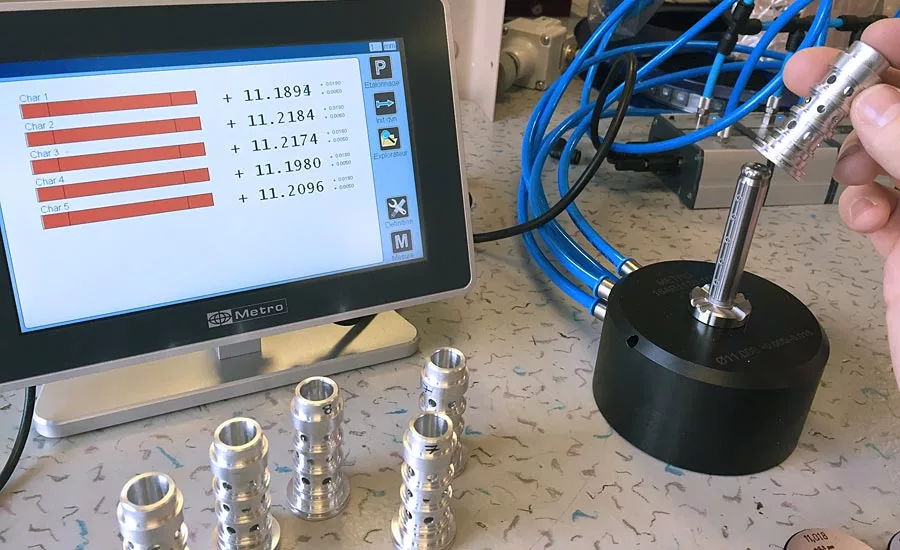

Another common use for air gages is the matching together of two mating components. For instance, in the hydraulic industry, they match sleeves and spools. You measure the inside diameter of the sleeve using an air probe and the outside diameter of the spool using an air ring. You measure both parts at one time and can see the clearance between them to verify the match. This method is also quite common in fuel injectors.
